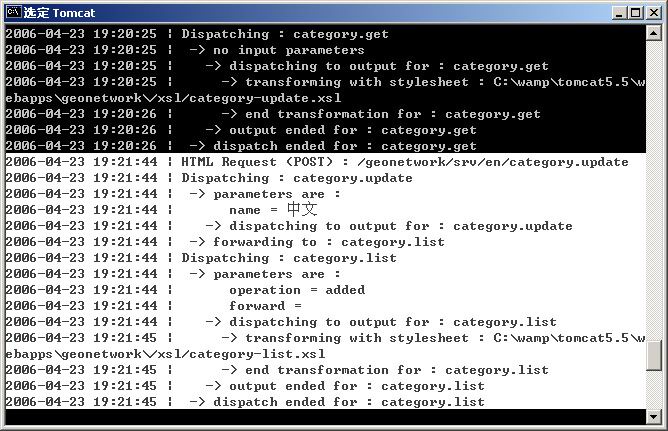

Just an example, I want to insert a new category named “中文” by :
create a new category by http://127.0.0.1:8080/geonetwork/srv/en/category.get
after submitted, the tomcat console dispalys as the white part:
Output of Tomcat console

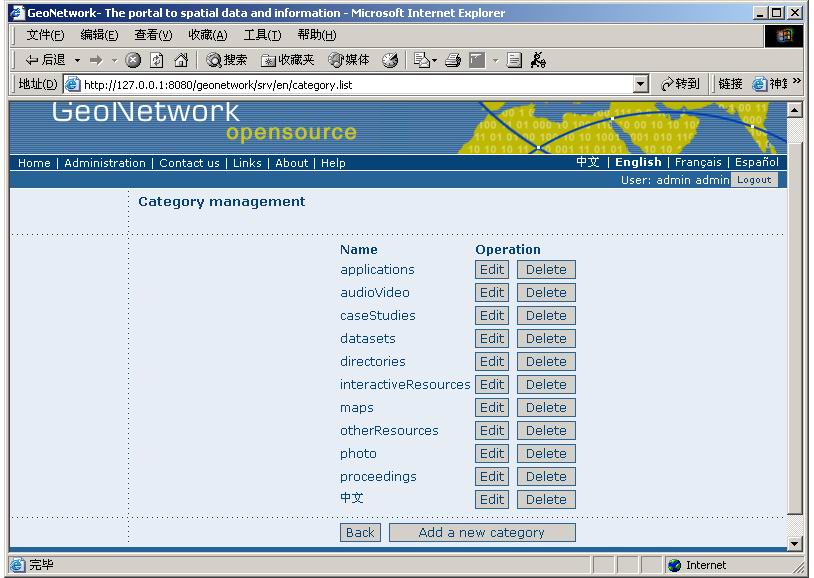

But the result page GeoNetwork shows is as following (the first record):
Insert result shown in Geonetwork

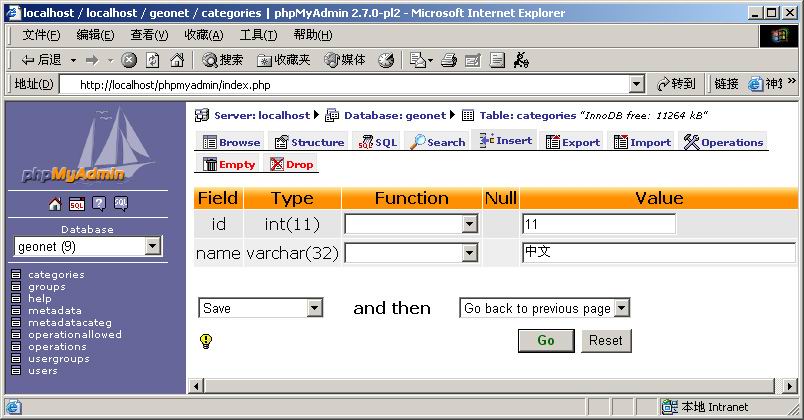

I checked the backend database Mysql by phpMyAdmin, which is the same (the first row with id 11):
Insert result shown in phpMyAdmin connecting to Mysql
But when I updated this record directly in phpMyAdmin as following (the record id=11):
update the record with a Chinese string in phpMyAdmin
Check the result in phpMyAdmin (first row with id=11):
the updated result shown in phpMyAdmin
And Check the result in GeoNetwork, it’s normal as I expect(the last one):
The updated result shown in GeoNetwork
