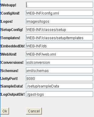

The obstacle I'm encountering is that I'm unable to actually use the GAST
app; I can't get past the initial GAST configuration panel. That is,
something is wrong with the configuration as is and I don't have the tools
to determine exactly what it is - even though I kept all basic system
configuration defaults (also used the default/embedded Jetty server) when I
first installed and began using GN. My GAST configuration can be seen in the

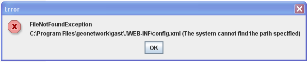

attached gif. When I click OK to accept this configuration (and ideally,
move on to the GAST app where I want poke around and test out the Export
functions), I get the error message seen in the attached 'error1' gif -
pertaining to the path to the config.xml file. My conclusion being that the
ConfigXml path is incorrect, I set it to *C:\Program
Files\geonetwork\web\geonetwork\WEB-INF\config.xml*, and proceed to get the
same error message, this time related to web.xml, in the attched error2 gif.
So I set that path like the previous one, click OK in GAST config, and get
an error message (error3) related to db.conf - which pops up again and
prevents GAST from opening when I attempt to re-start it. At this point
(twice now), I navigate into the gast folder where I have Geonetwork in
Program Files, and delete the temporary
*previousGastConfig.properties*file, which restores my default
settings and allows me to open GAST again -
and I'm back to square one.

Interesting!
For another option, and for the record, here's the solution that worked for
me (from Victor Epitropou):
"In the 2.4.x branch, I recall that the provided gast.bat and gast.sh
scripts worked without problems,
however starting from the 2.6.x branch they trigger a multiple folder
and file selection script.
Changing them as follows
[gast.bat] for Windows
%This is the original broken 2.6.x startup script, commented out.
%cd ..\gast
%start javaw %1 -jar gast.jar
%Fixed script starts below
cd ..\web\geonetwork
start javaw %1 -jar ..\..\gast\gast.jar [bolding mine - I'm using Windows]
[gash.sh] for Linux
#This is the original broken 2.6.x startup script, commented out.
#cd ../gast
#java $1 -jar gast.jar $2
#Fixed script starts below
cd ../web/geonetwork
java $1 -jar ../../gast/gast.jar $2
restores original functionality. Weird how this wasn't fixed or
mentioned over the whole 2.6.x branch's releases."
Simply changing the paths in the two lines of the GAST batch file script
fixes the problem, so when GAST is started again, the tool itself starts
rather than bringing you to and stalling out at the config panel.
Hope this or Anshumali's fix helps others who encounter the same obstacle!
Sam
View this message in context: http://osgeo-org.1803224.n2.nabble.com/basic-GAST-configuration-unable-to-open-use-app-tp6294987p6331465.html
Sent from the GeoNetwork users mailing list archive at Nabble.com.
If changing !Webapp! to "C:\Program Files\geonetwork\web\geonetwork", does
not fix the problem in your case, then maybe there is an issue particular to
your environment. Could you please tell me more about what operating system
you are using, the path to your GeoNetwork install, and the version of Java
you are using?
