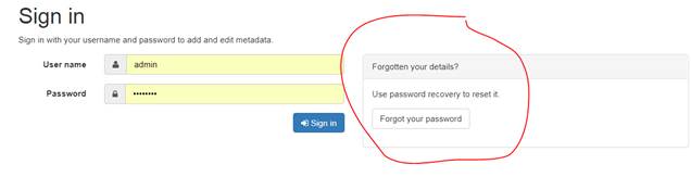

Hi
  1. How do I get rid of the ‘Forget password’ option here?
[cid:image001.jpg@...1687...]

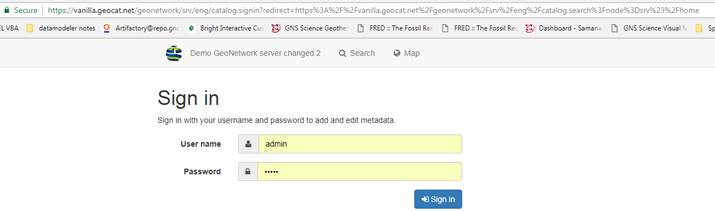

You manage to do it in your demo website:
[cid:image002.jpg@...1687...]

Hi Peck
That panel is displayed when the mail configuration is defined in the
settings, see this code:
https://github.com/geonetwork/core-geonetwork/blob/3.4.x/web-ui/src/main/resources/catalog/templates/signin.html#L83-L84
Some options:
1) Update the page to remove/comment the panel.
2) Remove the data-ng-show and add *style="display:none"*
3) Add below
https://github.com/geonetwork/core-geonetwork/blob/3.4.x/web-ui/src/main/resources/catalog/js/LoginController.js#L57
a property to control the display of the panel:
$scope.showRecoverPasswordPanel = false;
And update
to use it:
<div class="panel panel-default"
data-ng-show="gnConfig['system.feedback.mailServer.hostIsDefined'] &&
showRecoverPasswordPanel">
4) Other option more general that can be committed in GeoNetwork is to add
a new setting to control the display of the panel, would be similar to 3),
but using a configurable setting.
