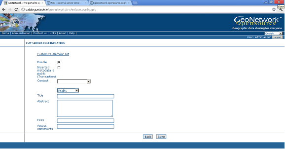

Hi GeoNetwork-Users.
I have successfully installed GeoNetwork v2.6.4 via a war file app under Tomcat servlet. However, when I test the CSW interface I get the following error.
See
1. http://catalogue.isde.ie/geonetwork/srv/en/main.home - GeoNetwork UI
2. http://catalogue.isde.ie/geonetwork/srv/en/csw?request=GetCapabilities&service=CSW&version=2.0.2 - file or directory not found

CSW Server is enabled.
[cid:image001.png@anonymised.com]

Hi,
to avoid outofmemoryerror, try to set -Xmx 1024m (or another number) for JAVA_OPTS in TOMCAT_HOME/bin/catalina.sh/bin
kind regards

Hi.
Thanks for the support from forum user provided. However, we are still
experiencing an error with the CSW ISO Test Profile GetCapabilities
operation. If anyone in the GeoNetwork community can help this would be much
appreciated?
Our environment is:
We have windows 2008 R2 x64, with Tomcat 7 (Tomcat/7.0.25)
java version "1.6.0_20"
Java(TM) SE Runtime Environment (build 1.6.0_20-b02)
Java HotSpot(TM) 64-Bit Server VM (build 16.3-b01, mixed mode)
Initial memory pool: 2048MB
Maximum memory pool: 2048MB
Thread stack size 1024kb
I also added “
-XX:CompileCommand=exclude,net/sf/saxon/event/ReceivingContentHandler.startElement”
To the java options
Still seeing the same error.
There is also another error in the logs not sure if this is important
26-Mar-2012 16:12:59 org.apache.catalina.loader.WebappClassLoader
validateJarFile
INFO: validateJarFile(D:\Tomcat
7.0\webapps\geonetwork\WEB-INF\lib\servlet-api-2.5-6.1.14.jar) - jar not
loaded. See Servlet Spec 2.3, section 9.7.2. Offending class:
javax/servlet/Servlet.class
Kind regards.
