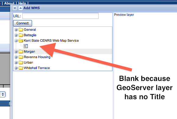

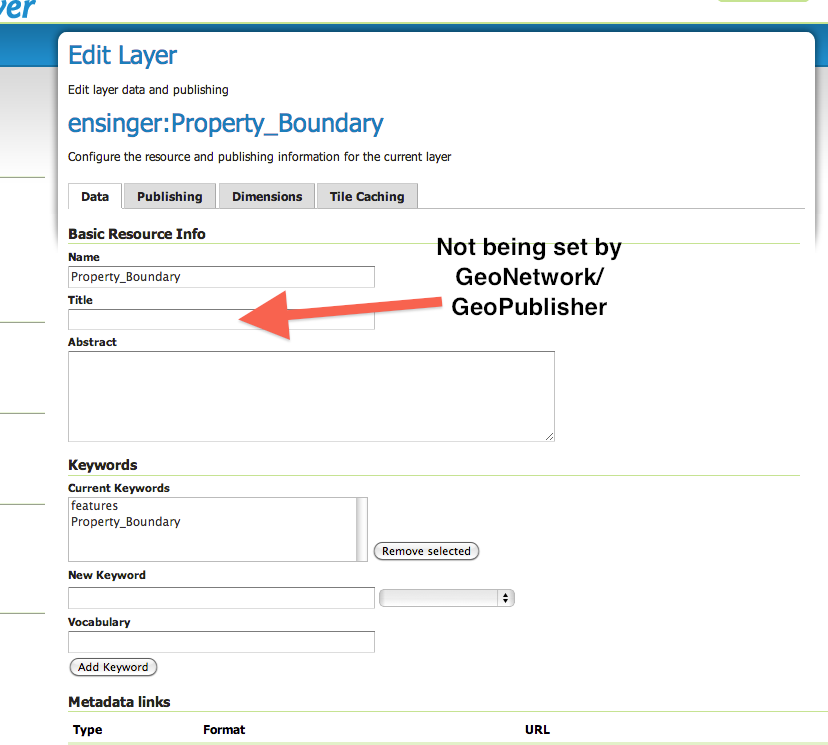

Using GeoNetwork v2.8 with GeoServer v2.2. In GeoNetwork I am able to
successfully upload a ZIP'ed shapefile to a metadata record and then use
the GeoPublisher to add that layer into GeoServer. The problem is the
title in the GeoServer layer does not get set and so when adding available
GeoServer layers to the main GeoNetwork map, the layer title is blank. See
two attached screenshots, one from the GeoServer layer configuration and
another from the GeoNetwork WMS browser. You can see that there is a radio
button to add
My question is, how do I ensure that the layer title gets set when
publishing with GeoPublisher. Is there a particular metadata field that
needs to be set? Is there a way for the GeoNetwork WMS server browser to
display the layer name instead of the title?
