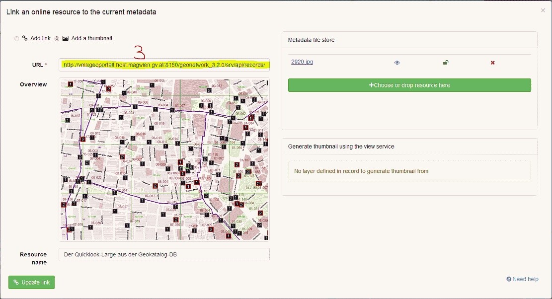

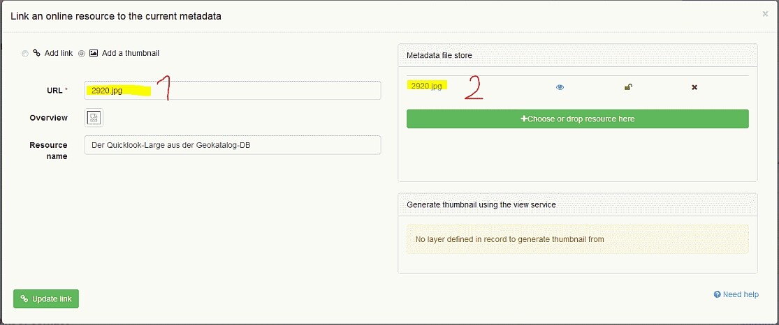

Importing works well - but the thumbnails (located in the 'public' subdirectory) will not show up :
When I edit an imported record I see a broken link under "Associated resources" .
When i click the edit-button to the right of it I see in the field "URL" the correct filename of the thumnail-image as defined in the info.xml (for example 5433.png).
Then, clicking the "select the ressource" button in the right part of the form, the field "URL" is updated with the full, correct path to the imported thumbnail and the picture is available :
http://servername.xxx.com:9999/geonetwork_3.2.0/srv/api/records/e4d8180c-fea7-4d94-8136-db62f24f214a/attachments/5433.png
(see screenshots).

The problem is a bug in GeoNetwork (https://github.com/geonetwork
/core-geonetwork/issues/1730). So until fixed the import of metadata with
files doesn't work properly and requires to edit each metadata in the
editor to do the actions you describe.
Does it clarifies the problem?
