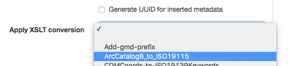

Hi Kevin
That is ESRI metadata, I think in previous versions of GeoNetwork could be
imported like that,but in 3.2.x was removed the FGDC metadata support. I
think should be related to that.
In any case you can import it, but will be transformed in iso19139 format.
In the import dialog, select the following xlst:
!import-xslt.png|603x135
