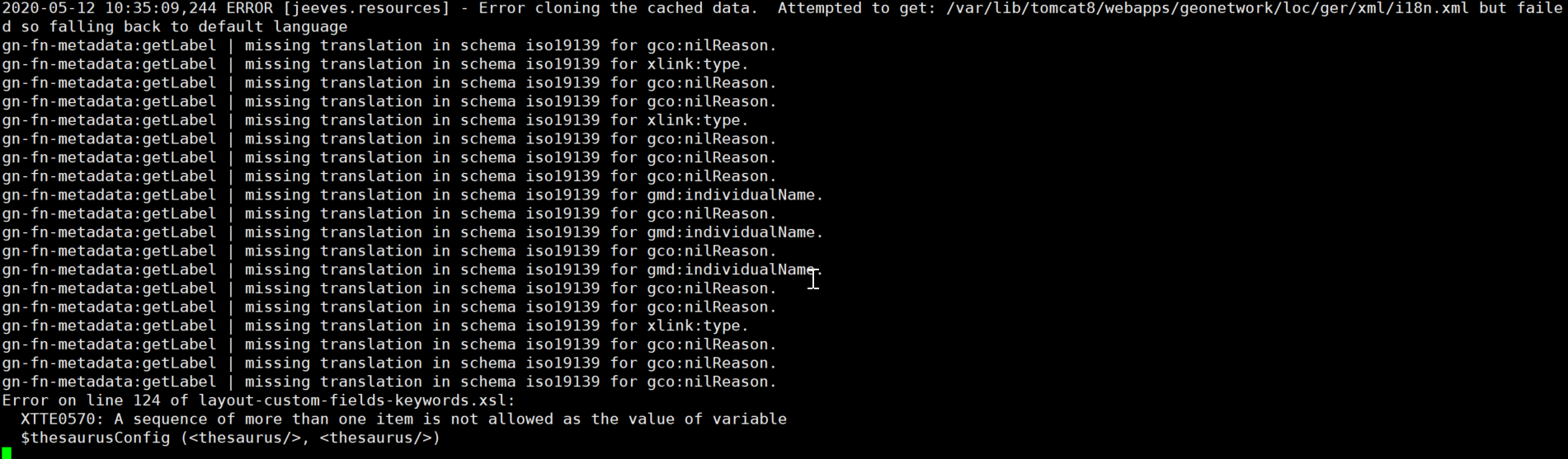

After that I tried to implement the INSPRE GEMET Thesaurus from the given Link in the Inspire Registry (as integrated in the geonetwork classification config). After that I had the same issue with the editor again, it was not working properly and just showing a blank page like in the above mentioned issue. After I deleted the Thesaurs all went smooth again. I have attached a screenshot of my Logfile which shows the error in more detail. I also checked my data directory and the rdf-File is actually there. What went wrong there and how can I get this thesaurus to work?

Sorry, I forgot the screenshot....
