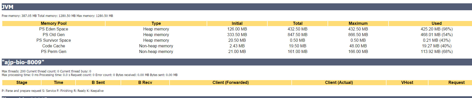

I add in attachment a screenshot of Tomcat memories, because I think it is
not "standard", and I have already changed *JAVA_OPTS* in the *tomcat.conf*
file.
