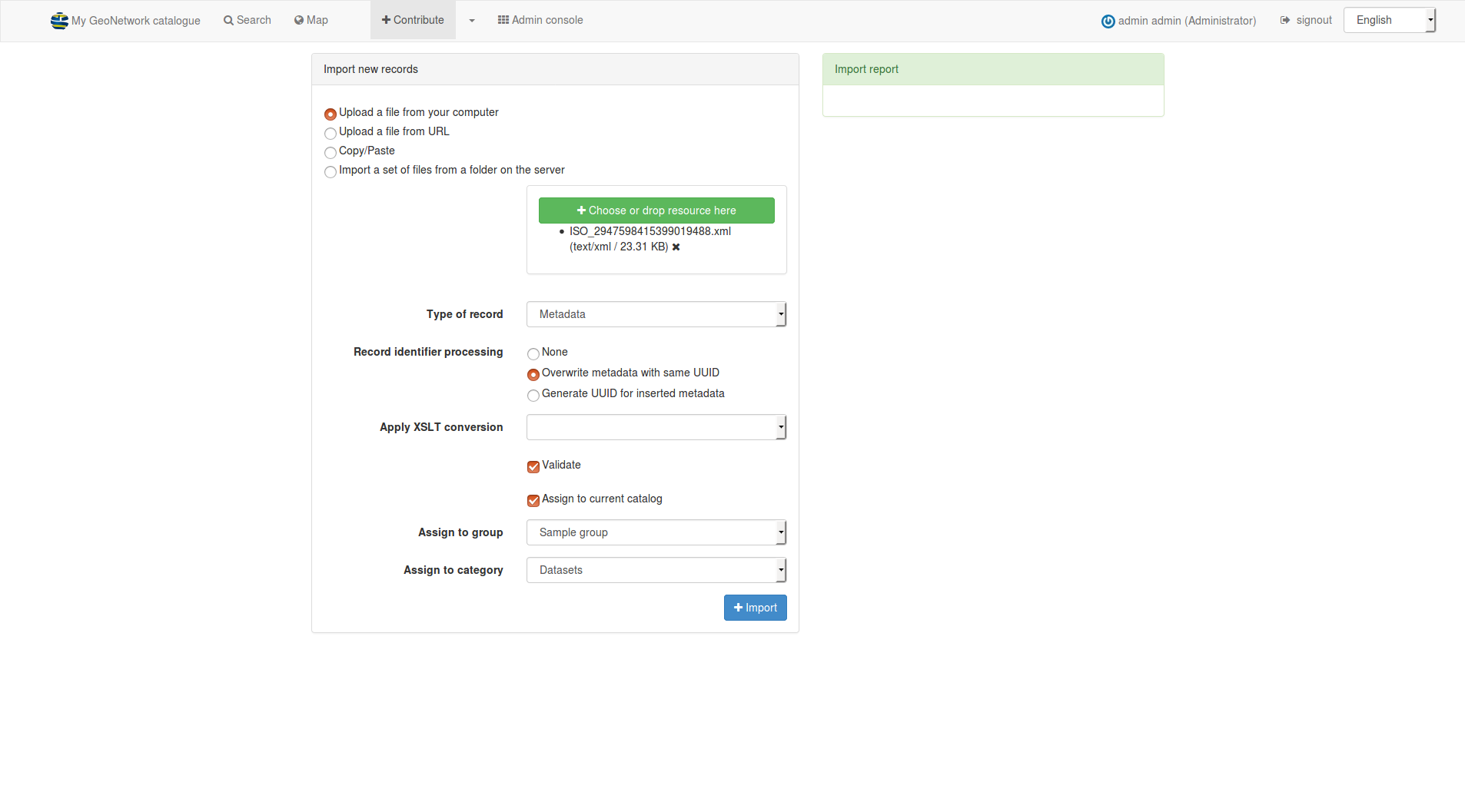

we're trying to migrate our infrastructure toward GN 3.x (we're already working with a 2.6.4). Since we usually generate metadata xml files (ISO 19115), I was trying to test the import metadata facility from the gui.
Problem is that :
* an exception[1] is thrown regarding the metadata[2] structure but no report is displayed[3]
* the metadata[2] should be INSPIRE valid according to [4]

Attachments :
[1] full stacktrace "catalina.out"
[2] metadata file "ISO_2947598415399019488.xml"
[3] GUI screenshot "My GeoNetwork catalogue My organization.png"
[4] INSPIRE validation tool "http://inspire-geoportal.ec.europa.eu/validator2/"
