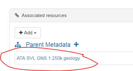

Hi,
My parent’s url under ‘associated resource’ is giving me an error. Is there something I need to configure? Please advise.
When I hover over parent link (red circle), it shows: https://data-uat.gns.cri.nz/metadata/srv/metadata/eb9f6170-7835-4438-9f02-348a4ea3212b
When I click on it, it gives me error (see below). The browser URL still shows https://data-uat.gns.cri.nz/metadata/srv/metadata/eb9f6170-7835-4438-9f02-348a4ea3212b
I expected it to resolve to
https://data-uat.gns.cri.nz/metadata343/srv/eng/catalog.search#/metadata/ eb9f6170-7835-4438-9f02-348a4ea3212b <https://data-uat.gns.cri.nz/metadata343/srv/eng/catalog.search#/metadata/%20eb9f6170\-7835\-4438\-9f02\-348a4ea3212b&gt; (correct one)
[cid:image001.png@...1691...]

Hi,
The thing to note is that my application is also called metadata.
In Edit mode,
The parent link below (red circle) is : https://data-uat.gns.cri.nz/metadata/srv/metadata/eb9f6170-7835-4438-9f02-348a4ea3212b (error)
Can someone pls tell me where I can change this : https://data-uat.gns.cri.nz/metadata/srv/metadata/eb9f6170-7835-4438-9f02-348a4ea3212b
to resolve correctly to
https://data-uat.gns.cri.nz/metadata/srv/eng/catalog.search#/metadata/ eb9f6170-7835-4438-9f02-348a4ea3212b <https://data-uat.gns.cri.nz/metadata/srv/eng/catalog.search#/metadata/%20eb9f6170\-7835\-4438\-9f02\-348a4ea3212b&gt; ?
If you see the view page (below), the parent link is correct: https://data-uat.gns.cri.nz/metadata/srv/eng/catalog.search#/metadata/ eb9f6170-7835-4438-9f02-348a4ea3212b <https://data-uat.gns.cri.nz/metadata/srv/eng/catalog.search#/metadata/%20eb9f6170\-7835\-4438\-9f02\-348a4ea3212b&gt;
[cid:image002.png@...1696...]
Any help will be appreciated. Thanks.

Hi,
The URL
should redirect you to
eb9f6170-7835-4438-9f02-348a4ea3212b,
that would be the role of the redirect rules defined here:
https://github.com/geonetwork/core-geonetwork/blob/master/web/src/main/webResources/WEB-INF/urlrewrite.xml
The expected redirection is of type "permanent redirect" (the browser
receives a HTTP 301 code and the current URL is changed), but in your case
the URL is not changed and you receive a raw backend error from the Show
service
<https://github.com/geonetwork/core-geonetwork/blob/master/services/src/main/java/org/fao/geonet/services/metadata/Show.java&gt;,
so I'd say the rewrite rule applied in your case is:
https://github.com/geonetwork/core-geonetwork/blob/master/web/src/main/webResources/WEB-INF/urlrewrite.xml#L380-L388
Whereas the expected one would be:
https://github.com/geonetwork/core-geonetwork/blob/master/web/src/main/webResources/WEB-INF/urlrewrite.xml#L276-L283
Before searching any further, could you please confirm which version of GN
you are using, and whether your urlrewrite.xml file is the same as the one
by default? Thanks.

Hi Oliver,
My GN version is 3.4.3. The urlrewrite.xml is the default one . I did not change anything in there.
See attached.
I made a discovery. If I change my application name to eg: ‘metadata343’ instead of ‘metadata’, my parent link resolves correctly.
So The URL https://data-uat.gns.cri.nz/metadata343/srv/metadata/eb9f6170-7835-4438-9f02-348a4ea3212b resolves correctly to https://data-uat.gns.cri.nz/metadata343/srv/eng/catalog.search#/metadata/eb9f6170-7835-4438-9f02-348a4ea3212b,
So the redirect must have got confused with 2 ‘metadata’ in the same url.
Thanks.
Peck

Yes, OK, thanks for trying out changing the application name. I'm surprised
though, because I thought that the URL rewrite mechanism was supposed to
ignore the *context-path* (i.e. application name) when resolving regexps.
My impression is that this is a bug on the urlrewrite filter (external lib)
<https://github.com/paultuckey/urlrewritefilter&gt; used by GN, but there may
be a workaround on the Geonetwork side of things.
If you don't mind opening an issue here
<https://github.com/geonetwork/core-geonetwork/issues&gt; with the elements
above so this can be discussed and eventually fixed or acknowledged, that
would be great. Thanks a lot!

Hi,
In Edit mode,
(error)
https://data-uat.gns.cri.nz/metadata/srv/eng/catalog.search#/metadata/%20eb9f6170-7835-4438-9f02-348a4ea3212b&gt;
[cid:image001.png@anonymised.com]
[cid:image002.png@anonymised.com]

Yes, OK, thanks for trying out changing the application name. I'm surprised though, because I thought that the URL rewrite mechanism was supposed to ignore the context-path (i.e. application name) when resolving regexps.
My impression is that this is a bug on the urlrewrite filter (external lib)<https://github.com/paultuckey/urlrewritefilter&gt; used by GN, but there may be a workaround on the Geonetwork side of things.
If you don't mind opening an issue here<https://github.com/geonetwork/core-geonetwork/issues&gt; with the elements above so this can be discussed and eventually fixed or acknowledged, that would be great. Thanks a lot!

Hi Oliver,
See attached.
Thanks.

Hi,
In Edit mode,
