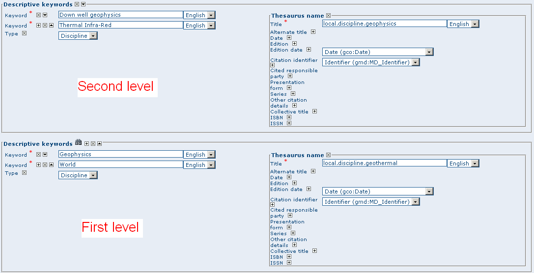

I'm currently investigating the thesaurus functionality for entering keywords because this could be a solution for entering hierarchical keywords.
My idea is the following approach:
- Create a thesaurus for the top level hierarchy.
- Create thesauruses for each sub-level.
In "/gmd:MD_Metadata/gmd:identificationInfo/gmd:MD_DataIdentification" can then be multiple "gmd:descriptiveKeywords" tags, with keywords from different thesauri.
I tried to visualize it in the attached screenshot.
1. Top level keywords from thesaurus 'local.discipline.geothermal':
   - Geophysics
   - World
2. Second level keywords from thesaurus 'local.discipline.geophysics':
   - Down well geophysics
   - Thermal Infra-Red
Another way would be to create the hierarchies directly in the RDF files for the thesauri, but I don't see a way at the moment that this is supported by GeoNetwork.
What is still missing in the trunk is support for that in the search interface.
Ideally for us it should be possible to choose the keywords in two or more stages like this:
https://www.seegrid.csiro.au/twiki/pub/Infosrvices/GeoNetworkGeothermalRequirements/Keywords_improved.jpg
I started by adding a new lucene index field for /gmd:MD_Metadata/gmd:identificationInfo/gmd:MD_DataIdentification/gmd:descriptiveKeywords/gmd:MD_Keywords/gmd:thesaurusName/gmd:CI_Citation/gmd:title/gco:CharacterString to be able to get the thesaurus names.
Is anyone already working on a thesaurus based keywords search or has other suggestions for this?
Thanks for any feedback!

Hi Michael,
I'm not really followed this thread but I believe what you need is already
available using an external thesaurus. RDF allows a hierarchy (broader and
narrower terms) that should fit to your needs.
Unluckily, "local" thesauruses do not support this hierarchy, al least
through the geonetwork's interface, but "external" (imported) thesauruses
do.
Thus, you could either use an "external" thesaurus and create the hierarchy
using a dedicated (external) tool, or improve the local thesauruses editing
interface, knowing most functionalities should already be there.
Jean

Can you please elaborate a bit on what functionality is exactly available for thesauri with a hierarchy? Because I thought that GeoNetwork doesn't support 'broader' and 'narrower' as it is not possible to _create_ these relationships with the editing interface as you stated above.
Also it would be neat to have that hierarchy represented somehow in the search box as I tried to show here:
Anyway thanks for your reply. I was wondering why no one answered yet. Maybe I'm writing too much or confusing? :slight_smile:

Michael,
The interface does not allow to edit broader and narrower relations. That's
why those relations are only usable, right now, with external thesauruses,
that you cannot edit inside geonetwork.
Have a try using the joined GCMD extract as external thesaurus. You will see
it can be imported and you can navigate in its hierarchy, using the
thesaurus admin page.
Unluckily, it is not used in the search box, nor in the metadata filling
form. So, just as it is, it is not very useful, I agree. I had tweaked
something to restrict keywords to be in the selected thesaurus, while
filling the metadata form, for a GN 2.2. But with no hierarchy, and have
nothing for the search box.
Maybe François Prunayre would have something closer to your needs : they are
working on thesaurus and keywords selection, I believe.
Cheers
al least through the geonetwork's interface, but "external"
(imported) thesauruses do.
create the hierarchy using a dedicated (external) tool, or
improve the local thesauruses editing interface, knowing most
Also I'm a bit confused about the use of the 'users' and the 'devel' list. A lot of development discussion is done on the users list, so I apologize for the crossposting. Maybe someone can tell me, which list is the best for questions like this.
Cheers,
   Michael

Michael,
relations. That's why those relations are only usable, right
now, with external thesauruses, that you cannot edit inside
geonetwork.
thesaurus. You will see it can be imported and you can
navigate in its hierarchy, using the thesaurus admin page.
metadata filling form. So, just as it is, it is not very
useful, I agree. I had tweaked something to restrict keywords
to be in the selected thesaurus, while filling the metadata
form, for a GN 2.2. But with no hierarchy, and have nothing
for the search box.
needs : they are working on thesaurus and keywords selection,
I believe.
Cheers
Jean

  Yeah, sorry for the longish email. Thanks, I figured
that it could be done in this way.
  > Unluckily, "local" thesauruses do not support this hierarchy,
  > al least through the geonetwork's interface, but "external"
  > (imported) thesauruses do.
  > Thus, you could either use an "external" thesaurus and
  > create the hierarchy using a dedicated (external) tool, or
  > improve the local thesauruses editing interface, knowing most
  > functionalities should already be there.
  Cheers,
     Michael
geonetwork.
for the search box.
I believe.
