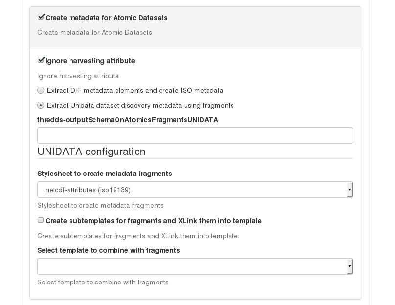

The problem is that appears only a text box with the label "thredds-
outputSchemaOnAtomicsFragmentsUNIDATA" and I don't know what I have to
write into it.
Is it an bug of geonetwork?
Best regards
Alberto

but still, I haven't had the same problem. Could you kindly forward/post
a screenshot with the page that only shows a textbox?

I usually write:
/iso19139 /
on that text input. Only after writing that do I get the UNIDATA
configuration part showing up.
I send a screenshot to show how the harvester looks like with that text
input.
Regards,
Filipe

Mmm,
it the log I find many expeptions like:
Thrown Exception java.lang.IllegalArgumentException: Schema not
registered : DIF during dataset processing
I did not choose to extract DIF metadata as you can see in the
screenshot.
Anyway, I tried both options (DIF metadata and UNIDATA dataset
discovery metadata) and several inputs in the textbox (weird strings
too) but the result is always the same, always the same exception.
What I'm doing wrong?

Mmm,
screenshot.
On Wed, 2015-10-21 at 11:53 +0100, Filipe Freire wrote:
I usually write:
/iso19139 /

Hi Filipe,
the catalog url is correct, I pasted in a browser to check it.
It points to a thredds server on localhost (http://localhost:8080/…).
I don't know if could be a problem.
I tried the same options as you (hence without "Create metadata for
Atomic Datasets" option, but i will need it because my metadata are
inside netcdf files) and the exception changed:
registered : during dataset processing
It seems like it doesn't use the schema I specified in the text box
("iso19139") and has a "null" schema.
Furthermore I cannot save the configuration of the harvester and I find
the following exception in the log:

I also am wondering if it doesn't like it on a local server. Do you have a public facing THREDDS catalog link that one of us could look at?
If so, I would be willing to try to harvest your dataset using GeoNetwork 2.10. There are definitely some issues with the way Thredds and netCDF data is pulled into GN (does not pull in all the metadata* - it is not a complete record). However, I can successfully harvest our thredds instance so maybe if I try yours we can at least get closer to troubleshooting whether it is GN 3.0 or Thredds misbehaving for you.
In case this helps, the settings I currently use are:
Catalog URL > http://xxx.xxx.xx/thredds/xxxx/xxx.xml
Use Account > not checked
X Create ISO19119 metadata for all services in the catalog
X Create metadata for Collection Datasets
  X Ignore harvesting attribute
  X Choose Extract DIF metadata elements and create ISO metadata
    Select schema for output metadata records > iso19139
X Create metadata for Atomic Datasets
NOTE: The .xml is important for the catalog URL and you do need to make sure the iso19139 stylesheet is loaded in your templates from the admin page (but it won't even show in the dropdown if it's not, so I'm guessing that is not your issue).

Furthermore I cannot save the configuration of the harvester and I find the following exception in the log:
2015-10-21 16:00:48,810 ERROR [jeeves.service] - Exception when executing service
2015-10-21 16:00:48,810 ERROR [jeeves.service] - (C) Exc :
org.quartz.JobPersistenceException: The job
(HARVESTER_GROUP_NAME.1717897d-88ee-40b4-816c-867b35960d3b) referenced by the trigger does not exist.
2015-10-21 16:00:48,810 ERROR [jeeves] - Error occurred within a transaction
But I suppose this is another problem therefore I will send another mail with an appropriate subject.
Regards
Alberto
