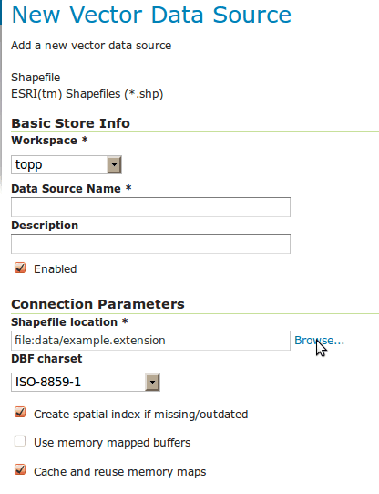

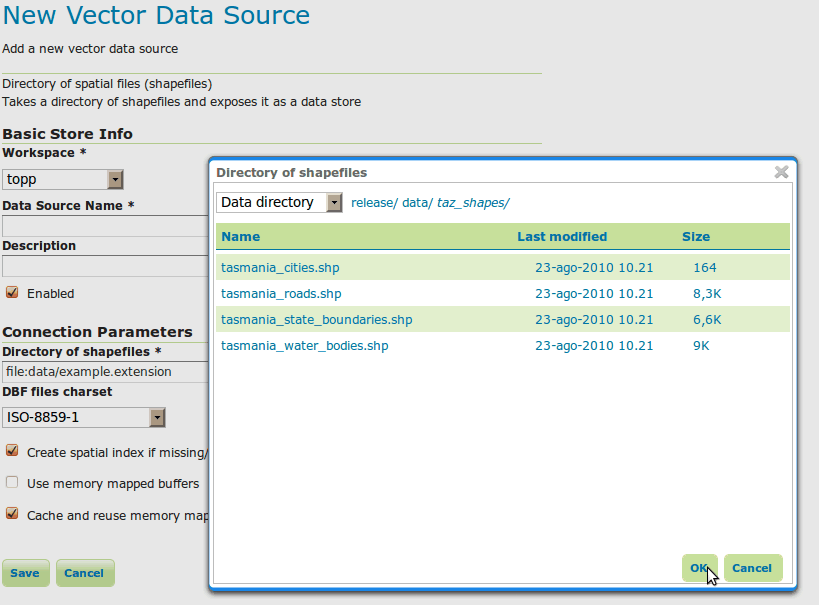

lately I've been doing a GeoServer workshop and I suffered watching students
stumble across some of the GeoServer GUI deficiencies.
One of them is the lack of a file chooser when creating
shapefile/directory/raster
stores. Having to copy and paste the path, and sometimes make it relative
to the data directory, is error prone and generally annoying.
The patch I've attached to http://jira.codehaus.org/browse/GEOS-4208 is meant
to solve the issue.
It provides a set of custom store panels for shapefiles, directory and
rasters that
come with a file chooser showing the server side file system and allowing to
choose a path by point and click.
I've made a quick screencast (sorry for the pitiful voice part of it)
showing how that
works:
http://demo.geo-solutions.it/share/chooser.ogv
(in order to view it outside of a Linux machine I suggest you install VideoLan,
it's good and can play the OGG vorbis format the screencast is made with)
If you can't see the screencast I've also attached a few screenshots to this
mail.
Highlights:
- allows to chose both files and directories
- provides quick access to user home and the data directory
- it is data directory aware, so it will generate path that are relative to it
  if you pick anything inside of $GEOSERVER_DATA_DIR/data
Feedback welcomed. I'd like to commit this improvements soon,
reviews for the patch I've attached to http://jira.codehaus.org/browse/GEOS-4208
are also welcomed

I just fired this thing up, and it works well, with one hitch. I see four entries in the drop down:
   Data directory
   Home directory
   C:
   D:
(It even included the volume names of each drive, nice). The hitch is that the Home directory displays the root of C:, not my home directory (defined in %USERPROFILE%) like I would expect.
Aside from that, it's a great and long-overdue enhancement to the UI. Thanks for putting this together!
Data directory
Home directory
C:
D:
Interesting. What is the user running GeoServer? Is it running as a service?
The "home" of the user that's administering the server makes no sense,
as that user might be on another machine and its OS level user name
is not known anyways. What you get should be the home of the user
that is running geoserver instead. If it's running as a service it might be
that the home in that case is C:/ (I guess I should compare the home
directory with the various file system roots, and if it's equal to one of
them, remove the home from the list)
Cheers
Andrea
Ing. Andrea Aime
Senior Software Engineer
GeoSolutions S.A.S.
Via Poggio alle Viti 1187
55054 Massarosa (LU)
Italy
phone: +39 0584962313
fax: +39 0584962313
http://www.geo-solutions.it
http://geo-solutions.blogspot.com/
http://www.linkedin.com/in/andreaaime
http://twitter.com/geowolf
Right you are, Andrea; I had this running in Tomcat, which is indeed installed as a service.
Just tried again running as "me" (had to get over the mental block of doing it this way, which always involves debugging for me). And the home directory works as advertised. The only thing I notice that's a bit odd is the displayed directories. The home directory is displayed for me only as "Mike/". It would be nice if the full path were displayed there, and not just that one directory. Ditto with the Data directory, which only shows "data_dir/". That may be a matter of prompt taste (my prompt has the full path at all times), but since the folder chooser drills down and displays multiple directories as it goes ("data_dir/ data/"), it would be nice to be consistent.
As for the service situation, if you could remove duplicates from the list, that would be a bonus. Home directory doesn't have much meaning in a service context.
Hope this feedback helps.
Thanks,
Mike Pumphrey
OpenGeo - http://opengeo.org
On 11/5/2010 5:46 PM, Andrea Aime wrote:
   Data directory
   Home directory
   C:
   D:
Cheers
Andrea
Ing. Andrea Aime
GeoSolutions S.A.S.
Italy
fax: +39 0584962313
Ok, then I have to remove it in case the home is equal to one of the other roots
consistent.
I disagree on this one. The paths are presented relative to the home directory,
and relative to the data directory on purpose. What you have in the dropdown
is a set of roots, not a set of bookmarks.
There already not much space in the file chooser, having it
display "c:\documents and settings\" would waste quite a bit of it.
In the specific case of the data directory the paths you get back from the
chooser are relative, so it makes sense to show them as relative as well.
service context.
Yup, agreed.
Cheers
Andrea
