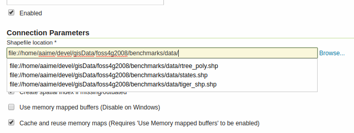

I would love to just auto-complete in the path text editor instead… and so here is a new pull
request:
https://github.com/geoserver/geoserver/pull/2702
The code auto-completes from the data dir or absolute paths (takes into account all available roots),
makes partial and case insensitive matches so that one can just quickly search for the bit she remembers,
and considers eventual file extensions configured in the editor.
Examples from home directory:
Inline image 1
and relative path in the data directory instead:
Inline image 2

one of my pet peeves about the file chooser is that going throw its UI is normally slow, click click click,
and if a directory has a lots of sub-directories, it takes time to list contents and then lots of scrolling or
browser search tool to find the right entry.
request:
Inline image 1
Inline image 2

On Wed, Jan 3, 2018 at 3:26 PM, Andrea Aime <andrea.aime@anonymised.com> wrote:
Hi,
request:
Inline image 1
Inline image 2
The code has been harder to write than expected, and so far it’s tested only on Linux,
not sure how it’s going to behave on other platforms, coders helping onother OSs would
be more than welcomed! (I want to give it a try on Windows, but the sucker it’s just installing
updates and telling me “the PC will be rebooted multiple times” since an hour ago…).
In any case, I’ve guarded auto-complete against exceptions, so if it fails, it should simply
return an empty set of completions and log the error.
Cheers
Andrea
GeoServer Professional Services from the experts! Visit http://goo.gl/it488V for more information.
Ing. Andrea Aime
@geowolf
Technical Lead

On 3 January 2018 at 17:22, Ian Turton <ijturton@anonymised.com403…> wrote:
From a quick skim of the Paths class that seems reasonable, no idea what it may break - I get 411 references to it in my workspace!
Ian

Yeah, that might be trouble… thankfully strict matching is off by default, after this change:
https://osgeo-org.atlassian.net/browse/GEOS-6811
Cheers
Andrea

request:
Inline image 1
Inline image 2
