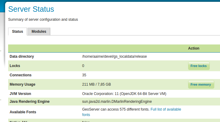

Also note the GeoServer status page screenshot, you’ll notice that JDK11 is using its own embedded Marlin version (as you probably
know, it has become the default renderer in JDK since version 9).
