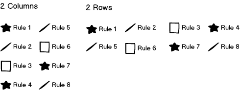

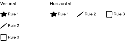

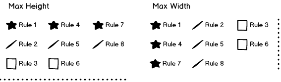

Hi Jody and all,
printing is an important use case for these new options, but it’s only limited to that.
The customer(s) currently asking for this functionality need them for a web client application where an horizontal / multi row layout would better fit a rectangular window meant to “host” the legend image(s).
In my opinion those kind of options do not match styling purpose, I think SLD is for styling map layers, not for laying out legends. These are orthogonal concerns. SLD should only drive icons rendering, not the way they are aggregated in the final bitmap.
What happens in printing is that we use the GeoServer printing plugin to aggregate legends in the PDF, but this is not driven by SLD. Instead it is driven by Mapfish printing layouts and clientside sent options. What we miss now is the ability to control the internal layout of multirule legend, that would be added by these new options.
In the meantime I prepared the GSIP proposal here: https://github.com/geoserver/geoserver/wiki/GSIP-146

On 16 May 2016 at 01:26, Mauro Bartolomeoli <mauro.bartolomeoli@anonymised.com> wrote:
Hi Jody and all,

2016-05-14 17:28 GMT+02:00 Jody Garnett <jody.garnett@anonymised.com>:
Your guess is a good one on printing.
I find that the style and the legend need to be designed together, or should at least be considered together.
On Fri, May 13, 2016 at 11:22 PM Andrea Aime <andrea.aime@anonymised.com1268…> wrote:
Hi Jody,
I’m wondering how much sense it makes to drive the layout of the legend from the server side…
isn’t it on the client that one knows what’s the general screen panel layout and can decide
what form factor works better.
If I had to guess, it seems to me the new options are most useful for map prints (one particular
case) than for interactive map displays on a screen, and thus changing based on the target
system, while maintaining the same style.
Agreed it would be nice to have a legend graphic request builder… you could make one, it’s
a good exercise in putting together a wicket UI :-p
Cheers
