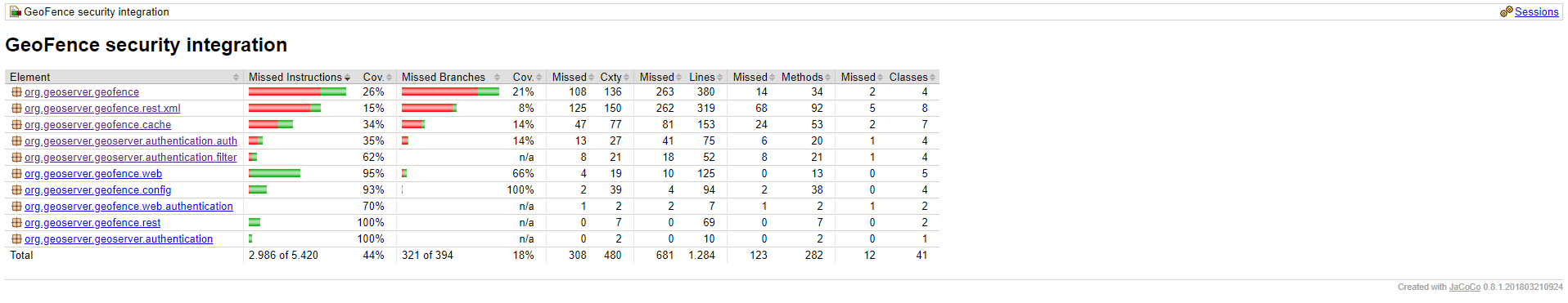

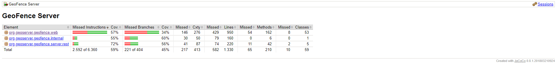

recently I worked on making geofence modules stable and complete enough to be evaluated as official GeoServer extensions.
Currently I have updated the checklist here
https://github.com/geoserver/geoserver/wiki/GSIP-164
and pushed a set of PRs [1][2][3][4] resulting in the following code coverage results
[1] https://github.com/geoserver/geoserver/pull/3058
[2] https://github.com/geoserver/geoserver/pull/3052
[3] https://github.com/geoserver/geoserver/pull/3046
[4] https://github.com/geoserver/geoserver/pull/3024

Dear PSC,
coverage results
[image: image.png]
[image: image.png]

The proposal wiki page still says 2.13. Are you targeting 2.14 or 2.15?
Also code coverage still seems pretty low for a security feature. Are you satisfied that the important parts have appropriate validation?

Hi Brad,
the test coverage requirements are indeed on the low side, maybe we should discuss a separate GSIP about increasing them.
But as far as rules go, Alessio’s proposal is within them.

I should have noted I already added my vote on the GSIP.
I was looking for Alessio’s opinion on the quality of the tests – test coverage (especially by line) isn’t the only thing that adds to value.

Dear all,
I agree that the test coverage might be indeed increased, nevertheless even if the percentage is not so high, notice that the core classes have a very good coverage.
As an instance the lower value (15%) on GeoFence module regards a package containing just POJOs used by the client to unmarshal instances through Spring Remoting. They are just plain classes representing some GeoFence objects ( org.geoserver.geofence.rest.xml).
On the other side most of the core classes have almost 100% coverage.
I would love (and for sure I will) add more tests on the rules and roles caching features and on the AuthenticationManager.
Until now the tests I have added should also cover:
  1. The load of the context from spring
  2. All the possible REST operations that can be done through the APIs
  3. Most of the operations that currently are possible via the WEB GUI
For sue something missing would be:
  1. More tests on the Limits filters by area
  2. Tests on the possibility of making specific attributes hidden/read-only/writable
Especially for those two, manual testing of course has been done successfully. Automatic testing should be added.
If you think that it would be better to add them at this stage, I can spend some more time before promoting the module, otherwise I can collect all those observations on some specific JIRAs.
Thoughts? Feedbacks?
Also @Emanuele Tajariol as the original author of the GSIP, what do you think about that?
Thanks everyone for dedicating time to this topic.
Alessio.

Alessio: thanks – that answers my question and allays my concerns. I am still +1 in any case.
Brad
