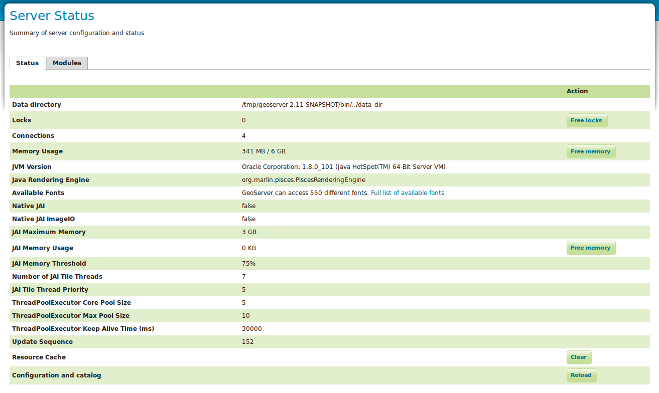

In Linux it seems to be working fine :slight_smile:
The log when using the binary release:
18 Feb 00:16:20 INFO [ows.OWSHandlerMapping] - Mapped URL path [/wfs] onto handler ‘dispatcher’
INFO: ===============================================================================
INFO: Marlin software rasterizer = ENABLED
INFO: Version = [marlin-0.7.3-Unsafe]
INFO: sun.java2d.renderer = org.marlin.pisces.MarlinRenderingEngine
INFO: sun.java2d.renderer.useThreadLocal = true
INFO: sun.java2d.renderer.useRef = soft
INFO: sun.java2d.renderer.pixelsize = 2048
INFO: sun.java2d.renderer.subPixel_log2_X = 3
INFO: sun.java2d.renderer.subPixel_log2_Y = 3
INFO: sun.java2d.renderer.tileSize_log2 = 5
INFO: sun.java2d.renderer.blockSize_log2 = 5
INFO: sun.java2d.renderer.forceRLE = false
INFO: sun.java2d.renderer.forceNoRLE = false
INFO: sun.java2d.renderer.useTileFlags = true
INFO: sun.java2d.renderer.useTileFlags.useHeuristics = true
INFO: sun.java2d.renderer.rleMinWidth = 64
INFO: sun.java2d.renderer.useSimplifier = false
INFO: sun.java2d.renderer.doStats = false
INFO: sun.java2d.renderer.doMonitors = false
INFO: sun.java2d.renderer.doChecks = false
INFO: sun.java2d.renderer.useLogger = false
INFO: sun.java2d.renderer.logCreateContext = false
INFO: sun.java2d.renderer.logUnsafeMalloc = false
INFO: Renderer settings:
INFO: CUB_COUNT_LG = 2
INFO: CUB_DEC_BND = 20.0
INFO: CUB_INC_BND = 8.0
INFO: QUAD_DEC_BND = 8.0
INFO: sun.java2d.renderer.gamma = 1.0
18 Feb 00:16:21 INFO [ows.OWSHandlerMapping] - Mapped URL path [/ows/**] onto handler ‘dispatcher’
and in the UI:
