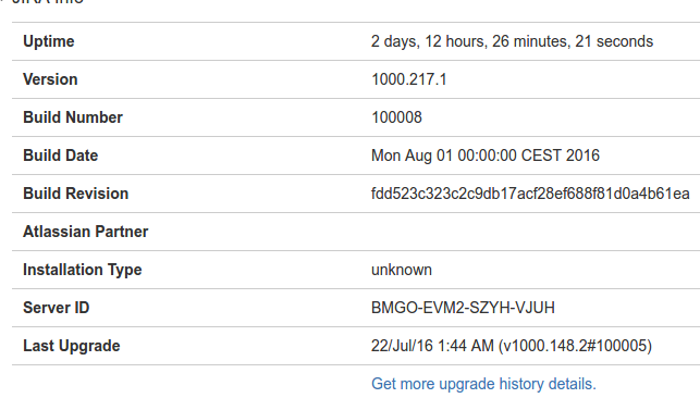

I went and checked the Jira version, the result leaves me a bit stumped:
!image.png|643x366
Err uh... version 1000?

On Fri, Aug 5, 2016 at 1:44 PM, Ben Caradoc-Davies <ben@anonymised.com> wrote:
Thanks, Andrea. I can confirm that this link works for me while unauthenticated. I hope it keeps working and does not disappear when Jira is upgraded.
Inline image 1
Err uh… version 1000?
