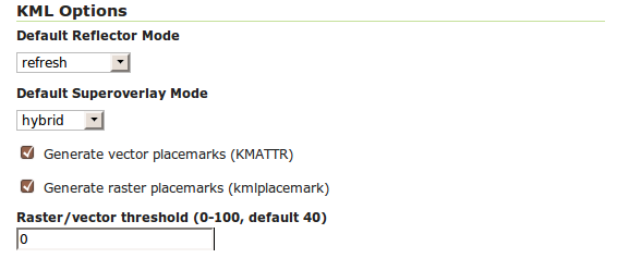

lately I've been quietly working on improving a bit
our KML generation story.
The first result of that work can already be found in
2.0.x in terms of defaults configurability: I've added
a panel in the WMS service configuration that allows
to set defaults for the reflector and the KML generation
in terms of:
- default reflector mode (refresh, superoverlay, ...)
- default superoverlay sub-mode
- whether to generate placemarks by default
- whether to generate placemarks over raster outputs
   when the number of vector features exceeds the KMSCORE
- setting the KMSCORE
See attached screenshot.
