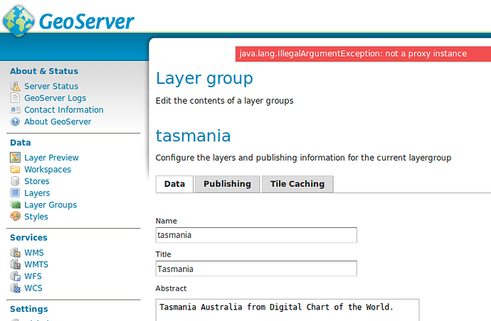

Hi Andrea,
I have already stepped on this issue like one month ago and I was not able to reproduce it and it never happen again so I forget about it.
Well now I just able to reproduce it :frowning: I use the Tasmania layer group and the Tasmania roads layer:
  1. Open in a new tab the layer groups page
  2. Open in another tab the layers page
  3. Open a the Tasmania layer group and change the layers draw order and click save
  4. Open the Tasmania roads layer and change the default style
  5. Open the layer group again and change the roads layer style to another
  6. Try to save, the error will happen:
With this steps it happens always :frowning:
Regards,
Nuno Oliveira

On Mon, Mar 13, 2017 at 12:12 PM, Nuno Oliveira <nuno.oliveira@anonymised.comit> wrote:
Hi Andrea,
Regards,
Nuno Oliveira
On 03/13/2017 09:27 AM, Andrea Aime wrote:
Regards,
Nuno Oliveira

On Mon, Mar 13, 2017 at 12:12 PM, Nuno Oliveira <nuno.oliveira@anonymised.comt> wrote:
Hi Andrea,
Regards,
Nuno Oliveira

Hi,
“the road to CatalogImpl is dark, and full of wrappers” → after checking your fix I confirm this is true :smiley:
Done a review and manual tested it, everything seems to be worked as expected now.
Thanks Andrea.
On 03/19/2017 11:12 AM, Andrea Aime wrote:
Thanks, that was quite useful.
To paraphrase the Game Of Thrones, the bug happens because “the road to CatalogImpl is dark, and full of wrappers”. [1]
Unfortunately some do not behave as they should and/or are not getting properly unwrapped on their way back during “save”.
One of those is the AdvertisedCatalog layer group wrapper… however, this is the strage thing, the wrapping should happen only during
capablities request, and instead it happens on every request after changing the default style of that one layer.
I’ve then tracked it down to ModificationProxy saving lists of proxied values into the original object on commit, which makes
the layer groups see a proxied list of layers. So to follow Nuno’s step:
  • Changing the order of the layers makes the collection of layers in the group replaced to a list of proxies to the layers
  • Changing the default style of a layer causes the inconsistency, the proxied layer will now report a style that’s different from the actual one (which just changed under its feet)
  • Grabbing the layer group for display makes it o thought the advertised catalog, which tries to filter the layers and then compares the two lists, finding them different because the default style of one of them does not match anymore
  • On save, advertised catalog failed to unwrap and this caused the original exception
    I believe I have fixed all the issues I’ve seen, pull request here:
https://github.com/geoserver/geoserver/pull/2170

On Mon, Mar 13, 2017 at 12:12 PM, Nuno Oliveira <nuno.oliveira@…4564…t> wrote:
Hi Andrea,
Regards,
Nuno Oliveira
Hi,
playing with GeoServer master I stumbled into this trace a couple of times, saving a layer group:
2017-03-04 14:42:20,086 WARN [geoserver.web] - Error adding/modifying layer group.
java.lang.IllegalArgumentException: not a proxy instance
at java.lang.reflect.Proxy.getInvocationHandler(Proxy.java:816)
at org.geoserver.catalog.impl.CatalogInfoLookup.update(CatalogInfoLookup.java:95)
at org.geoserver.catalog.impl.DefaultCatalogFacade.save(DefaultCatalogFacade.java:500)
at org.geoserver.catalog.impl.CatalogImpl.save(CatalogImpl.java:946)
at org.geoserver.security.SecureCatalogImpl.save(SecureCatalogImpl.java:1352)
at org.geoserver.catalog.impl.AbstractFilteredCatalog.save(AbstractFilteredCatalog.java:740)
at org.geoserver.catalog.impl.AbstractCatalogDecorator.save(AbstractCatalogDecorator.java:446)
at org.geoserver.catalog.impl.LocalWorkspaceCatalog.save(LocalWorkspaceCatalog.java:218)
at org.geoserver.web.data.layergroup.LayerGroupEditPage.doSaveInternal(LayerGroupEditPage.java:309)
at org.geoserver.web.publish.PublishedConfigurationPage.doSave(PublishedConfigurationPage.java:255)
at org.geoserver.web.publish.PublishedConfigurationPage$6.onSubmit(PublishedConfigurationPage.java:241)
at org.apache.wicket.markup.html.form.Form.delegateSubmit(Form.java:1307)
at org.apache.wicket.markup.html.form.Form.process(Form.java:974)
at org.apache.wicket.markup.html.form.Form.onFormSubmitted(Form.java:795)
at org.apache.wicket.markup.html.form.Form.onFormSubmitted(Form.java:708)
Now, the thing is, I cannot find a way to reproduce it, it just “happens” and I cannot figure out why.
Could anyone help me track down this beast? Once it happens I see the only way to fix things is
to reload the configuration.
If you’re into the code, here is a description of what’s going on.
The catalog facade on update needs to verify a few properties changed, and needs
to be submitted a ModificationProxy wrapping the actual catalog object to do so. Now, properly written
code always satisfies this property, e.g.:
Catalog catalog = …
LayerGroupInfo lg = catalog.getLayerGroupByName(…); // lg is a proxy here
// change lg properties
catalog.save(lg); // saving the wrapper proxy here
However, somewhere somehow, when saving a group on the UI the catalog gets a non wrapped object,
which does not allow to check what properties changed.
At first I thought it was due to the DefaultCatalogFacade changes, but I see the old catalog would
have tried to unwrap the proxy anyways to send events around, so I guess it’s something new in the UI
behavior instead.
