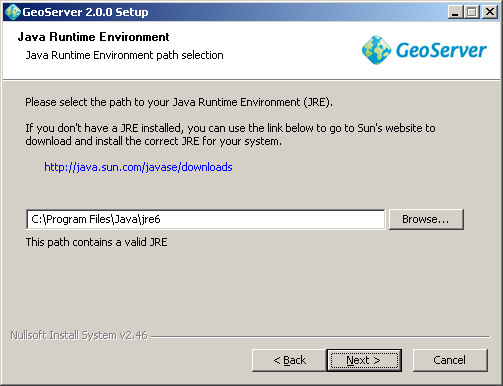

Page 5: JRE
The most common flub with setting a JRE is that you may actually have a JRE installed, but you don't have a %JAVA_HOME% variable set, and therefore GeoServer doesn't know what to do. This page looks for that variable, but if it doesn't find it, it looks in the registry (which is always populated) and throws that path into the field. Therefore, if you have a JRE, this will find it (and then write the %JAVA_HOME% variable accordingly). Note the real-time path verification. :slight_smile:
