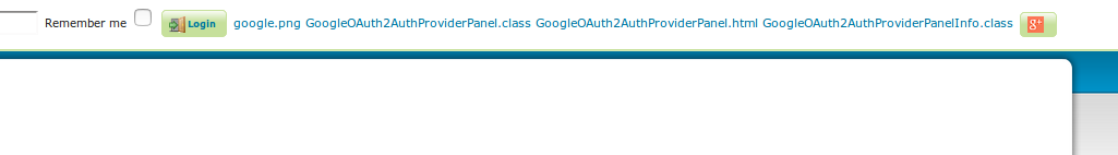

Finally, do you know why I get the names of java classes showing up next to the log-in form? (see attached photo)

  3. “why I get the names of java classes showing up next to the log-in form”. This should happen only when running on Eclipse. Try to build the WAR. You should be able to get the icons. In general the issue should be related to the fact that Spring is not able to stream the icon resource.

3) "why I get the names of java classes showing up next to the log-in form". This should happen only when running on Eclipse. Try to build the WAR. You should be able to get the icons. In general the issue should be related to the fact that Spring is not able to stream the icon resource.

  1. “Do you have any idea why this could be?” those services use cookies. On Google and GitHub I had a similar issue. I fixed that by checking for a session cookie (see https://github.com/geoserver/geoserver/blob/master/src/community/security/oauth2-google/src/main/java/org/geoserver/security/oauth2/GoogleOAuthAuthenticationFilter.java#L30)
  2. “How I can reproduce the problem”. Generate two different access_tokens associated to different roles. Assign different resources to the roles. Then open a browser window and login into the GUI with one of them. Now try to do a GetCapabilities request by passing the access_token as query parameter. If the session is not cached, you should be able to see different resources by simply changing the access_token. Otherwise you will need to close the browser session (or cleanup the cookies).
Sorry for the quick responses. Hope that those can be still be useful in order to allow you making further testing.

Thanks for your answer. It is strange, but I need to comment out this code for it to work at all, just the same as my client. Otherwise geoserver does not log me in (although the logging in process on google/github works fine). Do you have any idea why this could be?
Also, can you give me an example of how I can reproduce the problem you have without that block of code, so I can figure out a solution that works for both of us.
Thanks in advance!
            the icon resource.
                attached photo)
