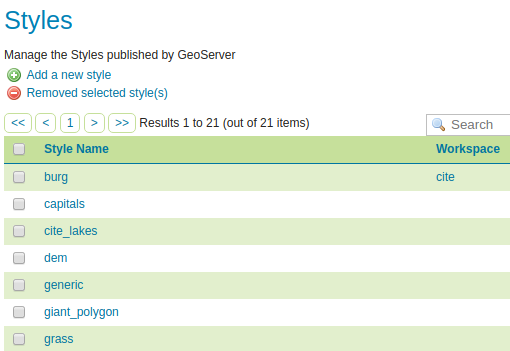

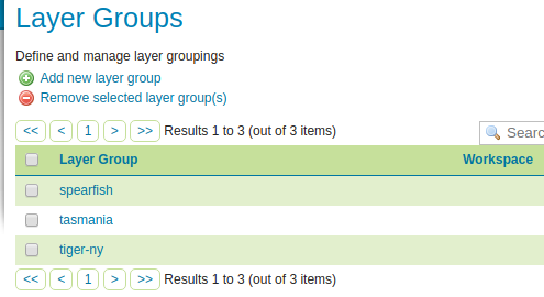

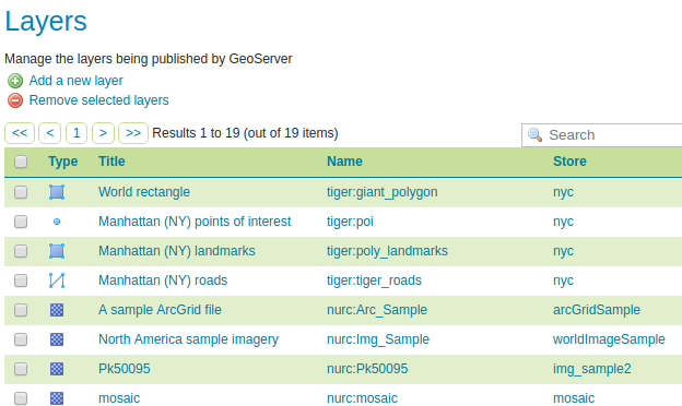

Name first, containers/context later
Styles page:
Layer groups:
Layers page:

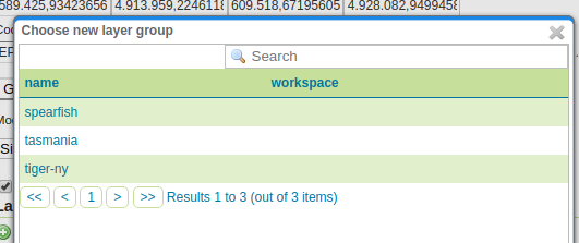

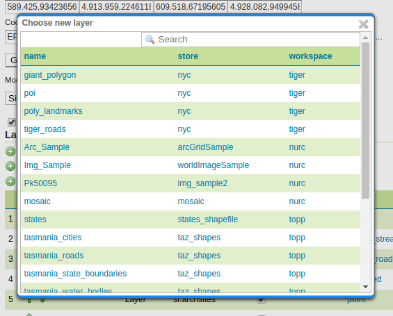

Picking layers to be added in layer group:
Picking layer groups to be added as child in a parent layer group:

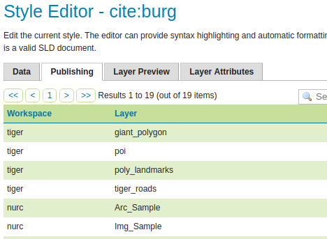

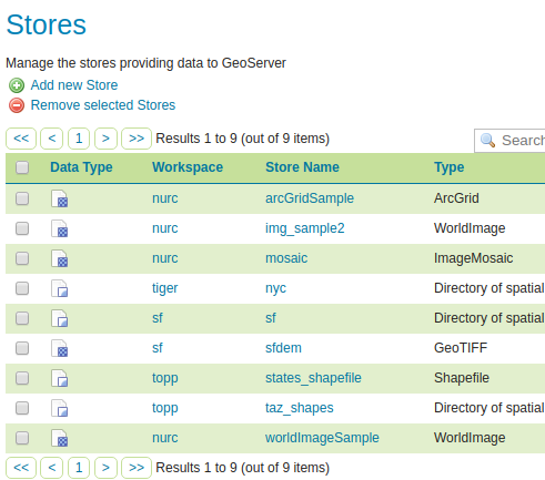

From container to contained
Stores page:

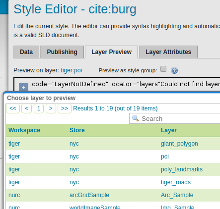

Style association in style editor:
Preview layer chooser:

The container to contained style makes more sense to me when the container is guaranteed
to be there (it also reads the same way things are named in services, with prefixes).
The name + context style seems to make more sense when the context is optional
(styles, layer groups).
I don’t think we’ll reach a consensus on which direction to take, but wanted to discuss it anyways,
just in case. Personally the ones that bother me now are:
  • The current layer page layout, even after years since the change I keep on getting on the store page when I want to open the layer one (am I the only one?) [1]. If the majority likes best the current layout, wouldn’t it makes sense to flip the store page too then?
  • The layer group and style preview popups, they are serving the same function with opposite layouts
