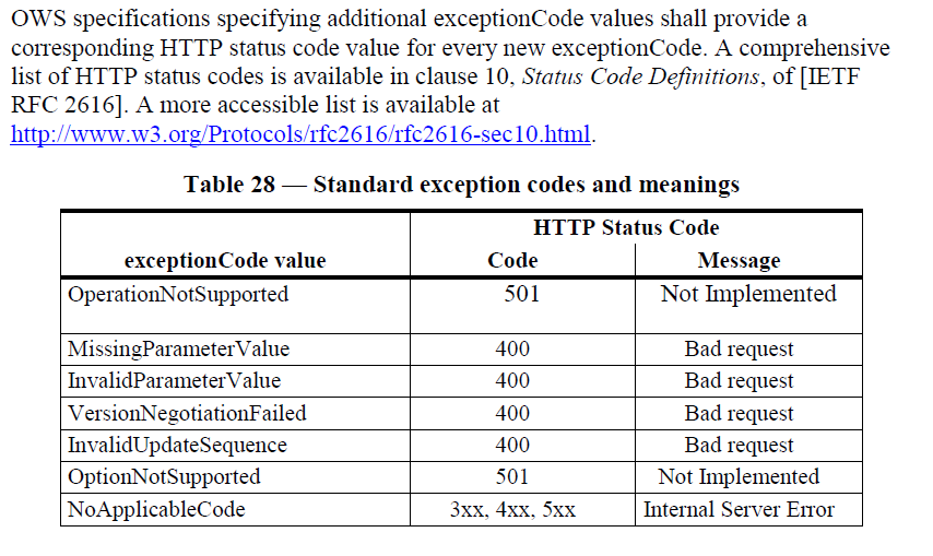

In OWS 2.0 (section 8.6) they actually made this more explicit, giving the
status code to be used:
http://portal.opengeospatial.org/files/?artifact_id=38867
Ah ha, interesting. Attaching a screenshot of the table for quick reference.
Not very far from what I proposed, but also specifies a message.
Cheers
Andrea

Yeah, good question. The mappings for the codes defined in OWS 2.0
are there and I think we'll use them.
OWS 2.0 also states services defining new codes will have to state which
http response code to use.
In general I'd like to see an enumeration like the one I did for WcsException,
it's easy to add two fields to specify the error code and the error message.

The OWS 2.0 spec appears to be pretty specific on the status codes, so
I did not consider chosing our own codes, but if we go for the above
ExceptionCode class a service could go and build its own object with
a specific http code and error message.
