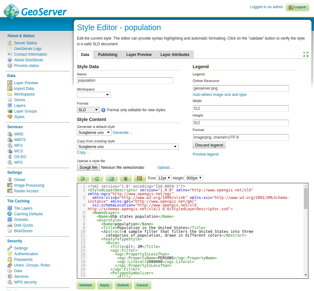

Going in order, the first set of changes I’ve made is to reduce need-less vertical space usage, here is a side by side comparison of

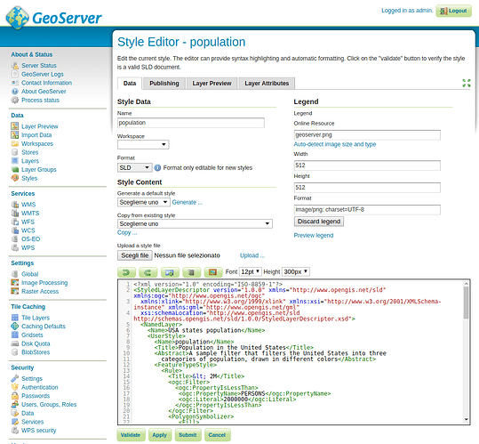

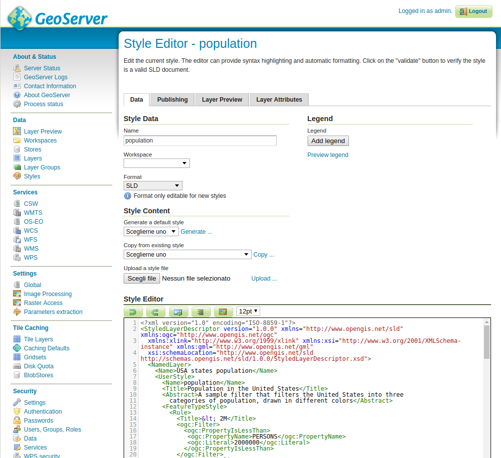

the style editor before the change, on a server that has the latest nightly, along with some extra plugins, so excuse the different menu entries,

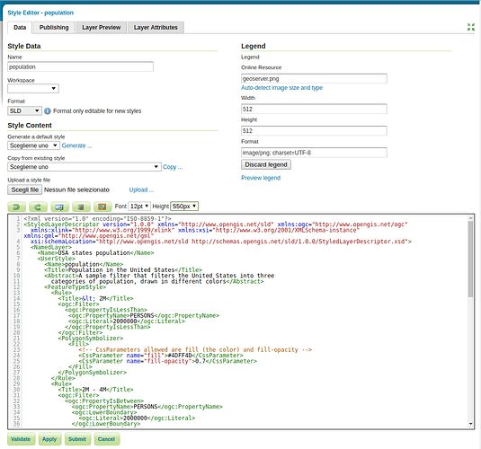

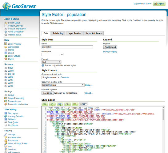

and after the change, on my local machine:

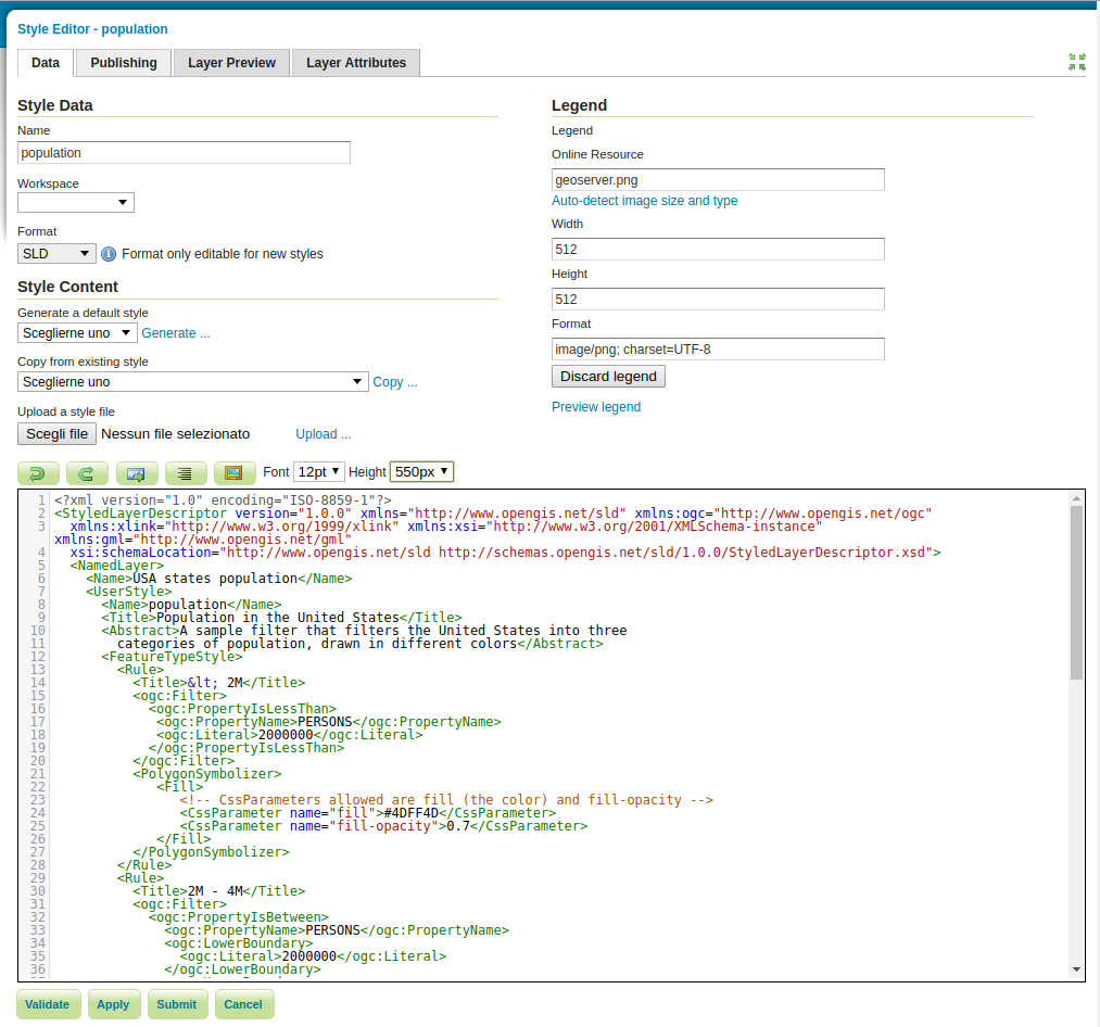

Small improvement, but enough to make the whole thing fill the screen in its default state. However, if you check the UI, you’ll see there is a new “height” drop down on top of the style
editor, and a tempting “arrows-out” icon on the top right. What happens if one clicks that icon, and then increases the height of the editor? This, “full screen” editing with less distractions,
aka “zen mode” (this is all you see in the browser, I did not cut away anything):
As you can see, the editor has been pumped up from 300px to 550px, or almost twice as big.
The “arrows-out” becomes “arrows-in”, clicking it you can return to the previous state.

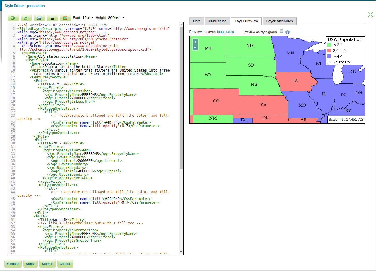

Now, the above form factor helps with a side by side comparison, but screens nowadays are large and
doing the same on a large one results in wasted space, it’s not a mistake that common style editors
done by HTML/CSS/JS pros have a different layout, a “side by side” one.
Can we do the same? Turns out, with a modern browser one can get there using the “flex” layout
mode, however, I’m not good enough with HTML/CSS/JS to get from prototype to something actually useful.

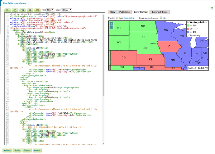

Here is what I have so far:
and the branch:
https://github.com/aaime/geoserver/tree/style_editor_side_by_side
To make it usable, imho, some more responsive design would be needed, where the editor and the map
automatically resize to fill the available space. A sub-par solution that would still be acceptable, imho,
could be to add a height dropdown to the map editor… having to click on two dropdowns to adapt
the page to the screen would be clunky but… better than nothing?
Bonus points for a draggable vertical separator allowing to adjust the relative width of editor and map.
However, as said, I’m having difficulties making that happen. Sorry, I’m an almost pure server side dev,
getting no occasions to work on the client side, even if I’d like to.
So… wondering, is there any good soul with the right client side skills that could bring this second part of
the work to completion? :slight_smile:

This looks quite helpful.
I’ve got some front-end experience - I’ll take a look at that branch and try and get something responsive working sometime this weekend.
Some initial thoughts/possibilities as to layout options:
  1. Fixed-width style editor with a variable width map.
  2. Style editor and map both take up half the width of the window.
  3. Style editor initialized to some starting width, with a draggable divider between it and the map. This might be tricky to get working with Wicket.

2018-05-06 15:51 GMT+02:00 Andrea Aime <andrea.aime@anonymised.com>:
Hi,
in the last few months I’ve tried, very much on and off (hack 2 hours, rest 2 months), to improve the style editor page, in order to get
more space for the editor itself.
I’ve come to a point were I can probably commit what I have, and getting close a significant improvement that I have troubles finishing myself.
These changes can be found in this pull request, I invite you to comment, review, improve it:
https://github.com/geoserver/geoserver/pull/2867
and the branch:

I’ve got some semblance of a responsive fullscreen mode here: https://github.com/tbarsballe/geoserver/tree/style_editor_side_by_side
Code Mirror editor and Layer preview now expand to fit the screen hight (minimum 300px).
If you resize the screen manually, they should update.
If the Layer Preview tab is not initially visible, it should be updated when selected.
I disabled the editor resize drop-down when in fullscreen mode since it automatically resizes instead.
There is a bit of tuning here and there that could still be done, mainly with regards to alignment of components.
Please try it out, and see what you think.

Squashed some commits, opened a PR with my changes here: https://github.com/geoserver/geoserver/pull/2867
Torben
