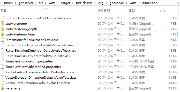

Hi Andrea,
After I build up the geoserver, it will generate some compile file in the geoserver\src\wms\target\test-classes\org\geoserver\wms\dimension.
In this folder include some class files and zip files(watertemp、custwatertemp_time、custwatertemp_depth、custwatertemp).
I don’t know those zip files how to generate?

Hi,
those files are part of the sources, many years ago there was no convention to put them in src/test/resources
and we adapted the maven build files to allow certain types of file to site among the sources instead (GeoServer
was not always built with maven).
So, those particular files can be found among the sources:
https://github.com/geoserver/geoserver/tree/master/src/main/src/test/java/org/geoserver/data/test
Code written in more recent times also has resource files in src/test/resources though, remember to check both
places.
Cheers
Andrea

Hi Andrea,
I find the zip file in the src/wms/src/test/resources/org/geoserver/wms/dimension.
There has one file named custwatertemp_time.zip
In this zip have NCOM_wattemp^2001-05-01T00:00:00.000Z、 NCOM_wattemp^2001-05-02T00:00:00.000Z、 NCOM_wattemp^2001-05-03T00:00:00.000Z tiff files, I find those file have some error(0x80070057 error) in the windows environment when I try to unzip them.
I don’t know this situation whether happens in Linux?

2017-12-04 17:07 GMT+08:00 Andrea Aime <andrea.aime@anonymised.com>:
Hi,
places.
Cheers
Andrea

I have know custwatertemp_time.zip have error in windows and have corrected.
I will continue to debug other errors in windows environment.

I just get the tiff files in Linux and recompress those files in windows environment.
I think it was not compressed file completely before.
I have not created a pull request on Github.
What did you change?
