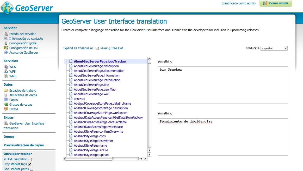

So what about a GeoServer extension to perform the translation?
I've been working on a prototype today, screenshot attached. Idea being there's a page in the ui allowing to create a translation and submit it to the developers (somehow). The resources are obtained from the classpath, the translation is stored under <data dir>/translation/GeoServerApplication_<language code>.properties.
If this seems like a good idea I can keep working on it as a vacation fun project.

On Mon, Aug 17, 2009 at 9:25 PM, Gabriel Roldan <gabriel.roldan@anonymised.com> wrote:
I’ve been working on a prototype today, screenshot attached. Idea being there’s a page in the ui allowing to create a translation and submit it to the developers (somehow). The resources are obtained from the classpath, the translation is stored under /translation/GeoServerApplication_.properties.

Mike Pumphrey ha scritto:
Hi there. I'm sorry, I'm kind of lost in this thread. I'd just like to know/have some sort of way for people to be able to translate the UI with minimal headache, so I can document it or make a blog post about it. Since 2.0 will eventually be out of beta, it would be nice to have approximately as many languages supported as we did before. :confused:
2.0 is actually already out of beta, RC1 has been uploaded to SourceForge already (we need to make a blog post about it btw...
will try to cook up one and submit it to your review
if none is available).

Chris Holmes ha scritto:
I think that's an awesome idea. Especially if as you translated your UI got updated. Maybe not in real time, but if you could do a reload. But even if that wasn't the case it'd still be great
I think submission would be fine if it was just finding the right file and attaching that to a jira issue. Or submitting the diff if it's updates to an existing one.
I did not look, but it should be possible to extend the resource loading
mechanism so that it picks resource files from the data directory as well. As for seeing the results straight away, we already have a "clear
wicket caches" link that shows up when Wicket is setup in development
mode, we can replicate the same funcionality in the i18n GUI.
One thing that is not clear to me is how this will play against UI
modularization. Atm we have one i18n file per GUI module:
find . -path "./*/src/main/java/GeoServerApplication.properties"
./core/src/main/java/GeoServerApplication.properties
./wcs/src/main/java/GeoServerApplication.properties
./wfs/src/main/java/GeoServerApplication.properties
./wms/src/main/java/GeoServerApplication.properties
./demo/src/main/java/GeoServerApplication.properties
And there will be another one for each new GUI module we roll out
(think the security UI, or any extension specific panel we might
  want to add)
The GUI above seems to build a single integrated file instead?
Wondering if it would be possible to keep the contributed translation
modularized. I guess one can use class.getResources(...) and the
use the URLs to pick up the contents of each file and generate
a similarly named file (the url path should contain the jar name,
shouldn't it?).
Anyways, if it's too hard it's definitely better to have a non
modularized translation that users can make, than no translation
at all :slight_smile:
Cheers
Andrea
Andrea Aime
OpenGeo - http://opengeo.org
Expert service straight from the developers.
an existing one.
Humm... next step for me is to look at how to apply the translation at
runtime, if possible.
that might do the trick, I'm not yet sure, but will look into it.
want to add)
The GUI shows up all the aggregate resources from the different
modules, but that's for the sake of simplicity for whomever is
performing the translation. The idea is then to create some sort of
diff that respects the modularity. It won't be any hard, as it's just
a matter of matching the keys for each .properties
shouldn't it?).
that's the idea.
The actual problem to solve after that is how to contribute back the
translation. Say the module creates the diff, how does the user send
it to us the easiest way?
I was thinking something as easy as a button "send to developers" or
such and the module sending an email. Attaching to jira automatically
would be hard, and any other thing like building a zip file and just
telling the user to send it back by email would work, but just not
that seamlessly.
Other ideas welcome though.
Cheers,
Gabriel
Cheers
Andrea
Andrea Aime
Agreed.
shouldn't it?).
that's the idea.
For starters I think just having the program generate a zip file that
the user then attaches to a jira issue is not going to be that hard...
wouldn't it? Or just tell people to send the translations to the
users or devel list.
that seamlessly.
Sending a mail automatically requires the user to configure a smtp
server with eventual access credentials. Accessing Jira has the
same access control issues.
Just give the user a zip file that he'll then send somewhere manually,
seems easy enough to me?
Cheers
Andrea
Andrea Aime
