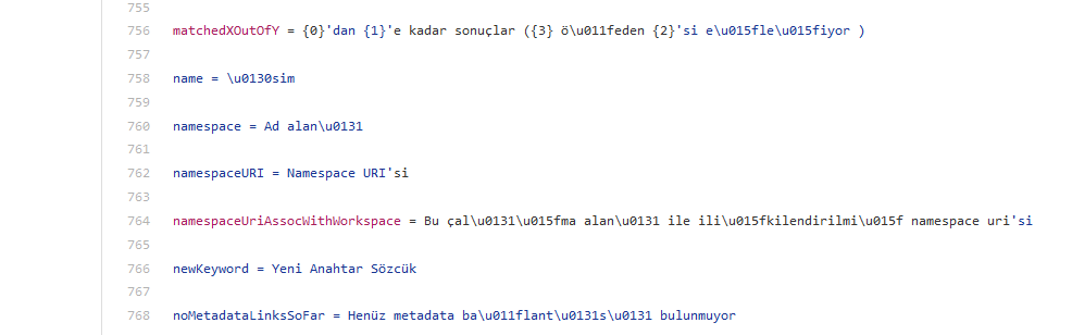

I really wonder why an other language breaks UI if running in a different Language than Turkish.
In addtion the resources we are talking about are 2-3 years (https://github.com/geoserver/geoserver/blame/678d3b43d88887ae7905bc5a9fc5c0330f6a1c65/src/web/core/src/main/resources/GeoServerApplication_tr.properties#L725) in the codebase and we never had problems like that. I’m wondering about the github viewer, it looks like the ’ char works like a “multi-line” seperator that includes the following properties into the string, maybe its a problem and this char should be escaped
Inline-Bild 1
Another cause of problem could be that the resource isn’t really UTF-8 and once if packaged its gets broken. Maybe the latest changes on the file itself changed file encoding?
If I’ll have some time a going to have a look at it…

Andrea, fantastic! Thanks for the fix. I updated translated String at Transifex : https://www.transifex.com/GeoServer/geoserver/translate/#tr/web_core/7529723?key=showingAllRecords
However, ther was a warning displayed in the Translation-UI, that not all Braces from origin string can be found in the translated String. I guess I should add a hint to https://github.com/fgdrf/geoserver/blob/406b761bf64a4bf345db2402efc9dd4d04ae3cc0/doc/en/developer/source/translation.rst

So to confirm, https://osgeo-org.atlassian.net/browse/GEOS-6927 has been opened against 2.6.2, so no Wicket
behavior changes, the translation has just been broken for a long time.
Turns out I was looking at the wrong string, a different one is used in case all matches appear in a single page, here is the fix, applied to all active branches:
https://github.com/geoserver/geoserver/commit/bdb599e52e0dc214233d6cbd8b50110367dbbc7f
I guess it needs to be brought back to Transifex to avoid further regressions?

There is an option to show Warnings for a ressource, e.g. for web_core module : https://www.transifex.com/GeoServer/geoserver/translate/#tr/web_core?warnings=yes
This would help to identify potential breaking translated fragements …
Downside (for a project haveing 42 resource files) : There is no global aggregated view to show this for all resources at one place.
