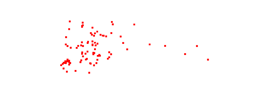

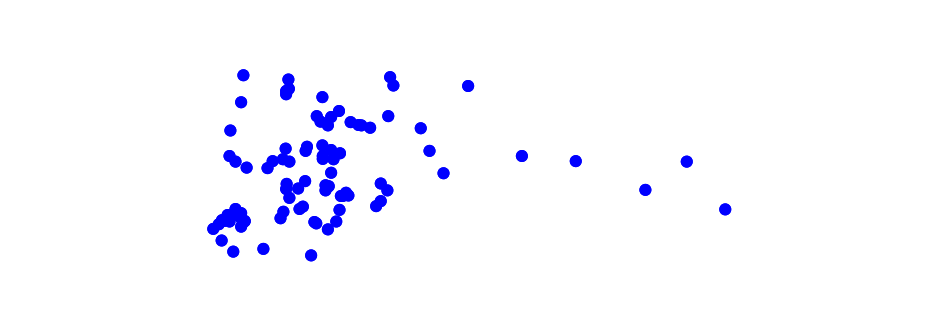

A WMS request specifying none of the params will looks like
the attached bugsites-basic.png file, whilst adding in the
request env=color:0000FF;size:8;name:circle will result in
bugsites-params.png.
