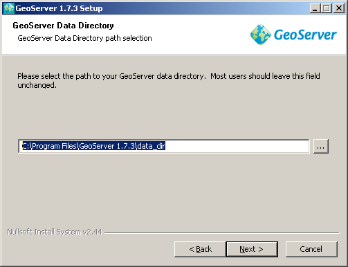

A couple of things:
* The second screen that tells the user which JDK will be used, or barks when there is no JDK. I have literally seen users cringe in pain when this screen pops up. It is way too much text, the text is poorly laid out, etc...
In my opinion this would much better be replaced with a screen "Choose Java" and basically is a text box and file chooser which allows one to choose the Java install they want. Basically the same way the screen that allows you choose the installation directory works.
* The data directory screen could use some love to. Too much text on it. To me a windows installer should basically do everything for you, and give you the option to do an "Advanced..." install if you really want to. But first time users of GeoServer having to read though the details of how the data directory works (often when they do not even really know what a data directory is) is bad.
-JD

Oooh, good points.
Ahh, this corresponds to (3) in my workflow. Are you suggesting that we remove this (3a) pop up entirely (unless a JAVA isn't found?) I could be okay with that.
This is what I had in mind for (3b).
I hadn't thought of this, but you're right that a "Complete/Custom" radio dialog is a great idea. (I don't know if this is possible with NSIS, but I'll check.) As for text cleanup, I'm on it. :slight_smile:

A couple of things:
-JD
-JD

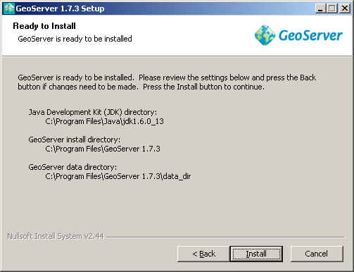

A couple of things:
out, etc...
-JD

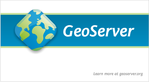

Hi everyone. I have created a test run of the new Windows installer, based on 1.7.3. Give it a whirl.
http://atlas.openplans.org/~mike/GeoServer_1.7.3_newinstaller.exe
Since I know that many people here don't have access to a Windows box, I've attached screenshots. Here's the workflow:
First is the splash screen (01), followed the by the welcome (02). If you are not running as an admin, the installer will abort (03), otherwise the license screen will show up (04). Next is the typical "where to install" page (05) and Start Menu location page (06). After that, the installer will ask for the location of the JDK (07), auto-populating the field with the %JAVA_HOME% variable, if it exists. The installer won't continue if it can't find a valid JDK (08). After this check, it asks for the location of the data directory (09), auto-populating this field with the %GEOSERVER_DATA_DIR% variable, if it exists. If it doesn't exist, the field will be populated with $INSTDIR\data_dir (i.e. the location of the built-in data directory after install), so this field is never empty. If you specify another directory, it will checked to see if it is valid and error if not (10), and if good, will say that it is using an existing data directory (11). If using the built-in da
ta directory, this installer will allow you to change the admin username and password (12). (This won't happen if using an existing data directory, so as to prevent clobbering existing security settings.) Finally, one final page allows for reviewing of settings (13), and after install, a final screen shows success (14).
This will install GeoServer as a service. It's not set to automatic startup, although that's easily changed. The Start Menu items are unchanged, although now they start/stop the service. When starting and stopping, a command line window shows up momentarily ("Starting/Stopping GeoServer 1.7.3") but then goes away! Hoorah!
The program now shows up on the Add/Remove Programs list, although the Uninstaller file remains in the Start Menu.
But anyway, assuming the user has a JDK installed and set up, the user only needs to keep clicking Next, and GeoServer will be installed on their system. :slight_smile:
Some of the suggestions made on this thread haven't been implemented yet (JAI checks, silent installer), but I wanted to get some of the basics nailed down first. Please test and let me know if there's anything that should be changed. Thanks to everyone who has helped me get started pushing this rock over the hill.
P.S. For anyone who reads NSIS, also attached is the script used to generate the installer. I wanted to get feedback on workflow before committing anything.
Thanks,
Mike Pumphrey

Hi Mike: I am going to try this one on vista for you (since doing a
sevice on vista is often a pain so I may catch something for you).
1. Initial prompted with the usual access control permission question
2. initial page looks great
3. license page is fine; I am used to a check box to enable the Next
button but whatever
4. directory etc okay
5. non pop up dialog to show the jdk is a great improvement
6. "Please select the path to your GeoServer data diregtory. Most
users should leave this unchanged"
7. Great work with the ability to change geoserver configuration user
name and password :slight_smile:
This is nice and short; but does not define who most users are. Perhaps:
"If you have previously set up a Geoserver configuration please
provide that path to your data directory; if this is your first time
using GeoServer an example configuration is provided below".
The default location of the data_dir causes problems in Vista; as you
are not really allowed to write to the Program Files Directory; there
is an AppData system directory that should be used.
Suggestion:
In anycase accepted all the defaults; and then opening the web ui was
not successful. Running the start geosever short cut did not help;
opening up the services control pannel allowed me to start geoserver
... however
- http://localhost:8080/geoserver produces a 504 SERVICE Unavailable
- http://localhost:8080/ does respond with a javadoc and geoserver link
So Jetty appears to be started (when I do so manually); but the war is
not working....
Jody

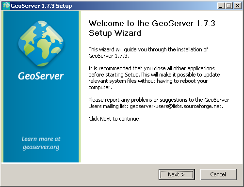

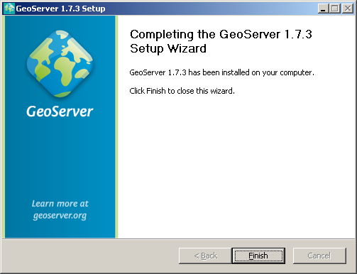

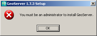

anything.
Thanks,
Mike Pumphrey
OpenGeo - http://opengeo.org

; Optional welcome text here
!define MUI_WELCOMEPAGE_TEXT "This wizard will guide you through the
installation of GeoServer 1.7.3. \r\n\r\n\
It is recommended that you close all other applications before
starting Setup.\
This will make it possible to update relevant system files without
having to reboot your computer.\r\n\r\n\
Please report any problems or suggestions to the GeoServer Users
mailing list: geoserver-users@anonymised.com \r\n\r\n\
Click Next to continue."

Function .onInit
; Splash screen
SetOutPath $TEMP
File /oname=spltmp.bmp "splash.bmp"
advsplash::show 1500 500 0 -1 $TEMP\spltmp
;advsplash::show Delay FadeIn FadeOut KeyColor FileName
Pop $0 ; $0 has '1' if the user closed the splash screen early,
; has '0' if everything closed normally, and '-1' if some error
occurred.

; Check the user type, and quit if it's not an administrator.
; Taken from Examples/UserInfo that ships with NSIS.
Function CheckUserType
ClearErrors
UserInfo::GetName
IfErrors Win9x
Pop $0
UserInfo::GetAccountType
Pop $1
StrCmp $1 "Admin" Admin NoAdmin
NoAdmin:
MessageBox MB_ICONSTOP "Sorry, you must have administrative rights in
order to install GeoServer"
Quit
Win9x:
MessageBox MB_ICONSTOP "This installer is not supported on Windows
9x/ME."
Quit
Admin:
FunctionEnd

; Find the %GEOSERVER_DATA_DIR% used on the system, and put the result on
the top of the stack
; Will return an empty string if the path cannot be determined
Function findDataDirPath
ClearErrors
ReadEnvStr $1 GEOSERVER_DATA_DIR
IfErrors 0 NoErrors
StrCpy $1 "$INSTDIR\data_dir"
NoErrors:
ClearErrors
; Put the result in the stack
Push $1
FunctionEnd
Function DataDirCheck
   \!insertmacro MUI\_HEADER\_TEXT &quot;$\(TEXT\_DATADIR\_TITLE\)&quot;
"$(TEXT_DATADIR_SUBTITLE)"
CheckDirAgain:
Call findDataDirPath
Pop $4
; This puts the JDK, if any, into the field.
!insertmacro MUI_INSTALLOPTIONS_WRITE "datadir.ini" "Field 2" "State" $4
!insertmacro MUI_INSTALLOPTIONS_DISPLAY "datadir.ini"
   ;\.\.\.and reads it back in \(may be redundant\)
!insertmacro MUI_INSTALLOPTIONS_READ $4 "datadir.ini" "Field 2" "State"
IfFileExists "$4\catalog.xml" Exist Errors
Errors:
StrCmp "$4" "$INSTDIR\data_dir" ErrorNewDir ErrorBadDir
   ErrorNewDir:
     ; This is the dir that will be created, so it&#39;s okay that it
doesn't exist.
; MessageBox MB_OK "Setup will create a new data directory at the
following path:$\r$\n$4"
StrCpy $DataNewOrUsed "New"
Goto NoErrors
ErrorBadDir:
MessageBox MB_RETRYCANCEL|MB_ICONSTOP "No valid GeoServer data
directory found in folder:$\r$\n$4$\r$\nPress Retry to try again or Cancel
to Exit." IDRETRY CheckDirAgain IDCANCEL Kill
Kill:
MessageBox MB_OK "Setup will now exit."
Quit
Goto CheckDirAgain
   Exist:
     MessageBox MB\_OK &quot;Setup will use the existing data directory
at:$\r$\n$4"
StrCpy $DataNewOrUsed "Used"
Goto NoErrors
NoErrors:
StrCpy "$DataDir" $4
   ; Writes environment variable
   Push GEOSERVER\_DATA\_DIR
Push $DataDir
Call WriteEnvStr
FunctionEnd

; One final page to review options
Function Ready
!insertmacro MUI_HEADER_TEXT "$(TEXT_READY_TITLE)" "$(TEXT_READY_SUBTITLE)"
; Big long string with all the settings
StrCpy $9 "Java Development Kit (JDK) directory:\r\n
$JavaHome\r\n\r\nGeoServer install directory:\r\n
$INSTDIR\r\n\r\nGeoServer data directory:\r\n $DataDir"
!insertmacro MUI_INSTALLOPTIONS_WRITE "ready.ini" "Field 2" "Text" $9
!insertmacro MUI_INSTALLOPTIONS_DISPLAY "ready.ini"
FunctionEnd
Suggestion:
starting Setup.\

!insertmacro MUI_PAGE_FINISH ; Done

; Splash screen
SetOutPath $TEMP
occurred.
ClearErrors
UserInfo::GetName
IfErrors Win9x
Pop $0
Pop $1
NoAdmin:
Quit
Win9x:
9x/ME."
Quit
Admin:
FunctionEnd
ClearErrors
IfErrors 0 NoErrors
NoErrors:
ClearErrors
Push $1
FunctionEnd
CheckDirAgain:
Pop $4
Errors:
   ErrorNewDir:
doesn't exist.
Goto NoErrors
ErrorBadDir:
Kill:
Quit
Goto CheckDirAgain
   Exist:
at:$\r$\n$4"
Goto NoErrors
NoErrors:
Push $DataDir
Call WriteEnvStr
FunctionEnd
Function Ready
FunctionEnd
button but whatever
starting Setup.\
; What to do when done
; !define MUI_FINISHPAGE_RUN "$INSTDIR\wrapper.exe -t
./bin/wrapper/wrapper.conf"
; Install Page order
; This is the main list of installer things to do
!insertmacro MUI_PAGE_WELCOME ; Hello

Function .onInit
; Splash screen
SetOutPath $TEMP
occurred.
ClearErrors
UserInfo::GetName
IfErrors Win9x
Pop $0
Pop $1
NoAdmin:
   Quit
Win9x:
9x/ME."
   Quit
Admin:
FunctionEnd
ClearErrors
IfErrors 0 NoErrors
NoErrors:
   ClearErrors
   Push $1
FunctionEnd
       !insertmacro MUI_HEADER_TEXT "$(TEXT_DATADIR_TITLE)"
CheckDirAgain:
Pop $4
       ;...and reads it back in (may be redundant)
Errors:
       ErrorNewDir:
         ; This is the dir that will be created, so it's okay that it
doesn't exist.
               Goto NoErrors
ErrorBadDir:
Kill:
Quit
Goto CheckDirAgain
       Exist:
         MessageBox MB_OK "Setup will use the existing data directory
at:$\r$\n$4"
         Goto NoErrors
NoErrors:
       Push GEOSERVER_DATA_DIR
Push $DataDir
Call WriteEnvStr
FunctionEnd
Function Ready
FunctionEnd
