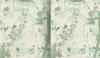

Hi,
First of all, I appreciate the hard work you folks, in particular at GeoSolutions, are doing, already for many years, on raster.
I noticed when upgrading from 2.4.3 to 2.6.1 that reprojected raster images from an Image Mosaic GeoTIFF source became less sharp. I tried many raster settings but to no avail. I noticed that in 2.6.2 "Advanced Raster Projection" could be switched off. Via the Java-code it appeared that this can be effected by setting ENABLE_ADVANCED_PROJECTION=false in e.g. the Tomcat environment settings. After upgrading to 2.6.2 and adding that setting, this immediately gave better/sharper results. See attached image for the differences before/after the setting. The original imagery is in EPSG:28992 and the reprojected/warped in EPSG:900913. There are no problems in rendering in the original projection, only when reprojecting/warping.
I am not sure why the above worked for me, but I thought I share this. Maybe it helps in further development. I can give more context if needed.

Hi Just,
you do have bilinear interpolation on, yes?
The issue is known, we are working on a solution, here: https://github.com/aaime/geotools/commits/warp_affine_aph
Still need to perform some checks before we merge it. The gist of it is that currently in order to handle
difficult projections we are doing first a reprojection and then a rescale to the desired target resolution,
which with bilinear interpolation result in a double resampling, the patch modifies the code paths
so that we can leverage the “warp/affine” reduction, that is, a code path that notices a reprojection
and and affine need to be performed in sequence, and merges the two in a single operation, thus
getting us a single bilinear resample

Hi Andrea,
Thanks. Yes I have Bilinear interpolation on. Nearest N. gave far worse results. Hard to see a difference with Bicubic. Also before ENABLE_ADVANCED_PROJECTION=false Bilinear gave the best results.

    Hi,
    ENABLE_ADVANCED_PROJECTION=__false in e.g. the Tomcat environment
    if needed.

Ciao Just,
my experience says that in most cases Bicubic is simply slower than bilinear.
Regards,
    if needed.

On Thu, Feb 19, 2015 at 11:53 AM, Just van den Broecke
<just@anonymised.com> wrote:
Hi Andrea,
Best,
Just
    if needed.
Hi Andrea,
Best,
Just
On 19-02-15 08:50, Andrea Aime wrote:
Hi Just,
so that we can leverage the "warp/affine" reduction, that is, a code
Cheers
Andrea
On Wed, Feb 18, 2015 at 11:07 PM, Just van den Broecke
<just@anonymised.com <mailto:just@anonymised.com>> wrote:
     Hi,
     if needed.
     Best,
     --Just
     www.justobjects.nl <http://www.justobjects.nl>
