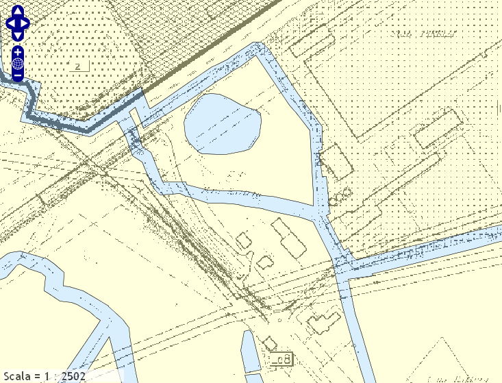

It seems there are still problems: attached you find two maps, one (raster_no_buffer.png) is a map without the buffer option; the second image (raster_buffer_160.png) is the same region, at the same scale, with same feature types but with the BUFFER option = 160. It's a quite different image quality. We're using OpenLayer with tiles 256x256 pixels.

Hmm... I first tried with 160 and could not see anything wrong, then
I realized geoserver previews have meta-tiling enabled so the
actual rendering tile is 256x3 pixels wide. I then tried with 1600
and yes, I can reproduce the issue.
I'll fix it for GeoServer 1.6.0-rc2, but probably not in 1.5.x,
that branch is "dead" as far as OpenPlans is concerned, that is,
we won't release a 1.5.5. If you really need one, you'll have to
create it by yourself or find someone that can do it for you.
