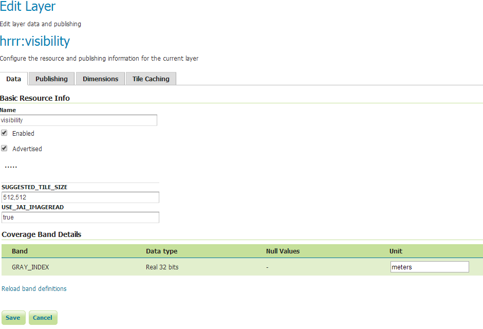

Daniele,
The only thing that I can modify is the Unit. Everything else is pre-populated and can’t be configured. Screenshot below.

Inline image 1

On Wed, Jun 18, 2014 at 5:47 PM, Mike Grogan <d.michael.grogan@anonymised.com> wrote:
Daniele,
  • Mike
Inline image 1

On Wed, Jun 18, 2014 at 11:35 AM, Daniele Romagnoli <daniele.romagnoli@anonymised.com> wrote:
I think it should be there.
When you edit a Layer, you should see it on the first tab (data) as the bottom section of the configuration.
Isn’t that there?

Looks like maybe this was just made available in 2.5.1? I am still on 2.5.
https://jira.codehaus.org/browse/GEOS-6372 shows a fix in 2.6-beta and 2.5.1.
Daniele,
  • Mike
Inline image 1
Isn’t that there?

Right.
2.5.0 has been released on March 20, 2014 whilst the improvement has been ported on April 10, 2014 and is part of 2.5.1.
Daniele

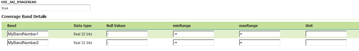

I can confirm it’s in and working in 2.5.1 - Just tested it on an couple of ImageMosaics - 3 band and 1 band. I’ve wanted this for a week or two but never got around to looking. Works well.
  • Mike
Inline image 1
Isn’t that there?

On Wed, Jun 18, 2014 at 12:52 PM, Jonathan Moules <jonathanmoules@anonymised.com…> wrote:
Cheers,
Jonathan

Daniele,
  • Mike
Inline image 1
Isn’t that there?
