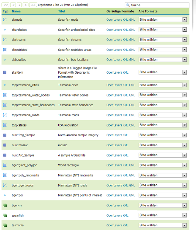

I observed the following misbehaviour of the latest nightly 2.8 build for Geoserver from 2015-03-03.

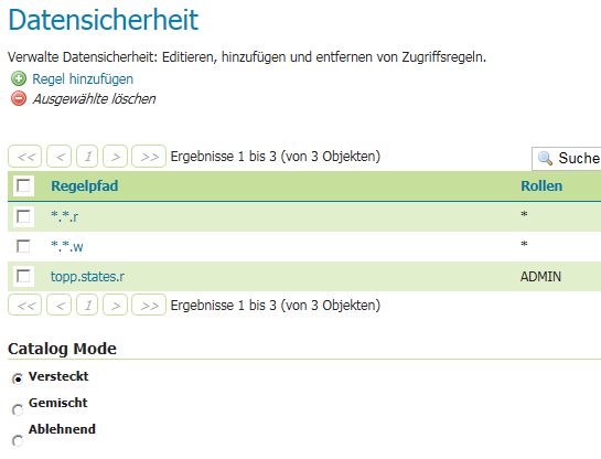

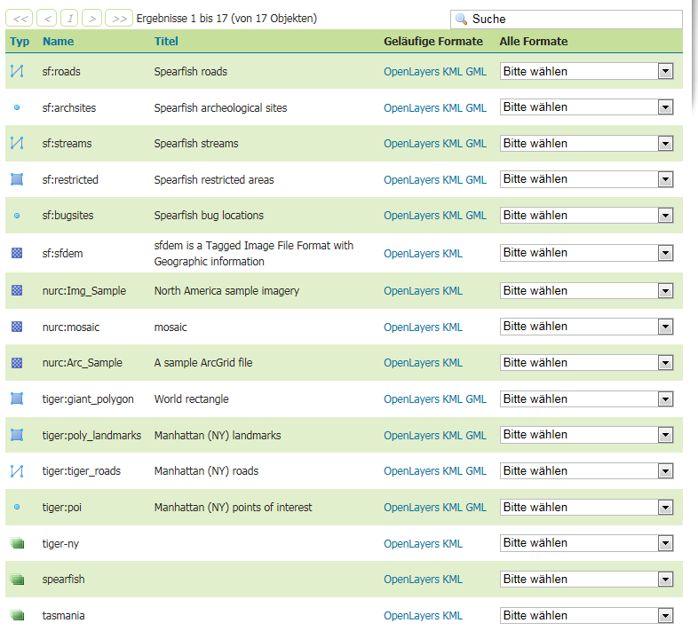

If you login with admin and visit the layer preview page, then you will get 22 layers listed (see figure1.png). Now, create a new data access rule for the layer topp:states. See the attached figure2.png for a screenshot of this situation. Finally, logout and visit the layer preview page again. It is expected that the layer topp:states is not listed because you are an anonymous user. However, all layers of workspace topp disappeared (see figure 3).
Does anyone made similar observations? Or, can anybody confirm my observation?

Hi Jurgen,
believe we lost this mail but yes, someone else did observe a similar issue
and I believe we added a fix in the meantime.
Could you confirm things are working for you now?

Hi Andrea,
I have seen that changes have been made in the file DefaultResourceAccessManager.java. I can confirm that these changes fixed the problem. Thank you for asking.
