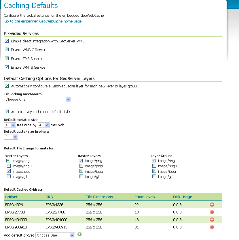

My Caching Defaults Configuration:
Inline image 1

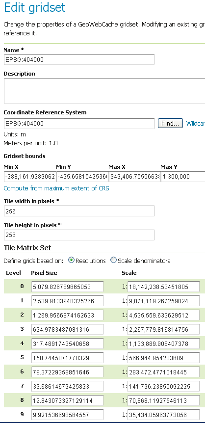

I have created New Gridset for EPSG:404000
Inline image 5

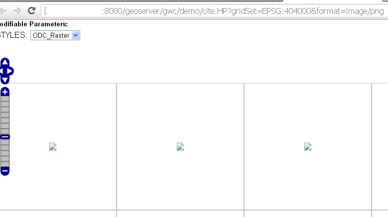

I have tested with XXX.XXX.X.XX:8080/geoserver/gwc/demo Link:
Inline image 8

Ciao Venky,
I would not expect the internal demo (which is really a simple preview) to work with custom gridset.
You should try to hit from a properly configured external client.
Inline image 1
Inline image 5
Inline image 8

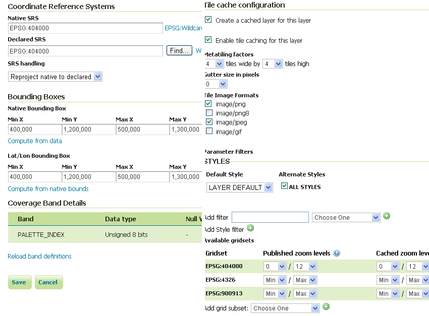

I have attached my layer settings screenshot for refefence. Is there anything I need to configure or anything I did wrongly?
Inline image 1
