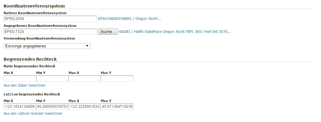

I created an ImageMosaic datastore pointing to the MrSID files.
In the publish dialog the wrong native coordinate system will be displayed.
I added the correct one into the user_projections and set this as the reference coordinate system.
See screenshot "GeoServer - CoordSys setting.png"
In the publish page I switched to the correct coordinatedsystem for Request and Response SRS.
See screenshot "GeoServer - Publish setting.png"
The preview and clients are showing the data now at the wrong position
Center around -62.27250, 32.37444 (EPSG:4326).

Dear Ruediger,
I’m not sure if that could be a specific problem in MrSID plugins but I don’t have your data so I can’t directly debug it.
However, do you have any chance to convert it to GeoTIFF without changing CRS, so that should have the same “wrong” CRS, and repeat the procedure with the GeoTIFF?
That would allows understanding if the problem is MrSID Driver specific or is it in the CRS management, instead.
Please, let me know. (Also let me know if you don’t know how to convert it to GeoTIFF through GDAL and double check the CRS for the 2 files is the same).

Hi,
I converted one tile of the MrSID to GeoTiff using the FME software.
The coordinatesystem was not changed in the FME.
After importing the MrSID and the GeoTiff tiles into Geoserver the WebGUI shows two different coordinatesystems.
MrSID: EPSG:2838
GeoTiff: EPSG:2913
The preview of the GeoTiff tile shows the correct coordinates.

Hi Ruediger,
I have downloaded your files.
On Mon, Jul 13, 2015 at 8:27 AM, Gubler, Ruediger <rgubler@anonymised.com> wrote:
Hi,
MrSID: EPSG:2838
GeoTiff: EPSG:2913
Mmm… I would say that FME changed the CoordinateSystem instead, since the reported EPSGs are different…
OR, GDAL is reporting a wrong EPSG from the MrSID file whilst FME is recognizing the proper one.
I did a test by using gdal_translate to convert from MrSID to GeoTIFF and in that case the GeoTIFF’s CRS is still EPSG:2838.
Therefore, the behaviour of my GeoTIFF is the same of MrSID.
Are you referring to the BBOX reported in the data tab of the layer configuration or are you talking about the layer preview instead?
I’m asking this because I’m still unable to see anything in layerPreview, and I see NaN coordinates too in LayerPreview.
(Wondering if it’s a problem related to this specific Projection).
Please, let us know.
Cheers,
Daniele
