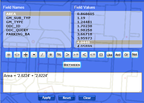

I am developing a web map application by using Geoserver 2.4.0. In my application, I have developed a module like Arcgis Query builder as shown below screenshot.
Inline image 1
In that, while I am using CQL Filter, WFS and WMS returns different result for same layer.

Hi This is the URL hitting geoserver:
http://xxx.xxx.x.xx:8080/geoserver/wfs?service=wfs&version=1.1.0&request=GetFeature&typeName=cite:Plymouth_Buildings&cql_filter=Area=‘2.0224’%20+%20’2.0224
On Fri, Dec 20, 2013 at 2:10 PM, Andrea Aime <andrea.aime@anonymised.com> wrote:
On Fri, Dec 20, 2013 at 6:43 AM, venky <venky.src@anonymised.com> wrote:
I am very new to CQL Filter, Kindly help me to fix this issue. Thanks in advance
The above is not enough to give you any response. Please share the requests generated by
your client (the URLs hitting GeoServer) and the full responses, that might give us something
useful to look at.
Cheers
Andrea
== GeoSolutions will be closed for seasonal holidays from 23/12/2013 to 06/01/2014 ==
Ing. Andrea Aime
@geowolf
Technical Lead
GeoSolutions S.A.S.
Via Poggio alle Viti 1187
55054 Massarosa (LU)
Italy
phone: +39 0584 962313
fax: +39 0584 1660272
mob: +39 339 8844549
http://www.geo-solutions.it
This is the full response from geoserver:
<ows:ExceptionReport xmlns:ows=“http://www.opengis.net/ows” xmlns:xsi=“http://www.w3.org/2001/XMLSchema-instance” version=“1.0.0” xsi:schemaLocation=“http://www.opengis.net/ows http://xxx.xxx.x.xx:8080/geoserver/schemas/ows/1.0.0/owsExceptionReport.xsd”>
<ows:Exception exceptionCode=“NoApplicableCode”>
ows:ExceptionTextCould not parse CQL filter list.
Encountered “'2.0224'” at line 1, column 19.
Was expecting one of:
<EOF>
“and” …
“or” …
Parsing : Area = ‘2.0224’ ‘2.0224’.</ows:ExceptionText>
</ows:Exception>
</ows:ExceptionReport>

Hi Venky,
the problem seems to be that you need to url encode the ‘+’ symbol (if not it will be converted to a space). The url should probably be:
http://xxx.xxx.x.xx:8080/geoserver/wfs?service=wfs&version=1.1.0&request=GetFeature&typeName=cite:Plymouth_Buildings&cql_filter=Area=‘2.0224’%20%2B%20’2.0224
Regards,Mauro Bartolomeoli
Yes. Its working now. Thanks for your help Mauro. Its really great. I will let u know if I met any further issue with this
