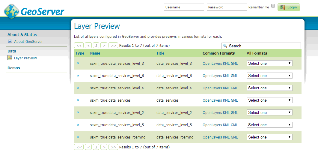

On our web tool screen,
(Embedded image moved to file: pic15385.gif)

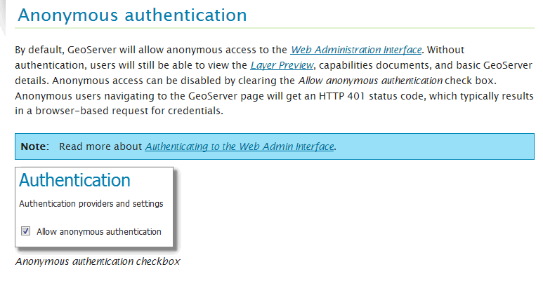

On your document,
http://docs.geoserver.org/2.3.2/user/webadmin/security/auth.html
(Embedded image moved to file: pic17283.gif)
On your document,

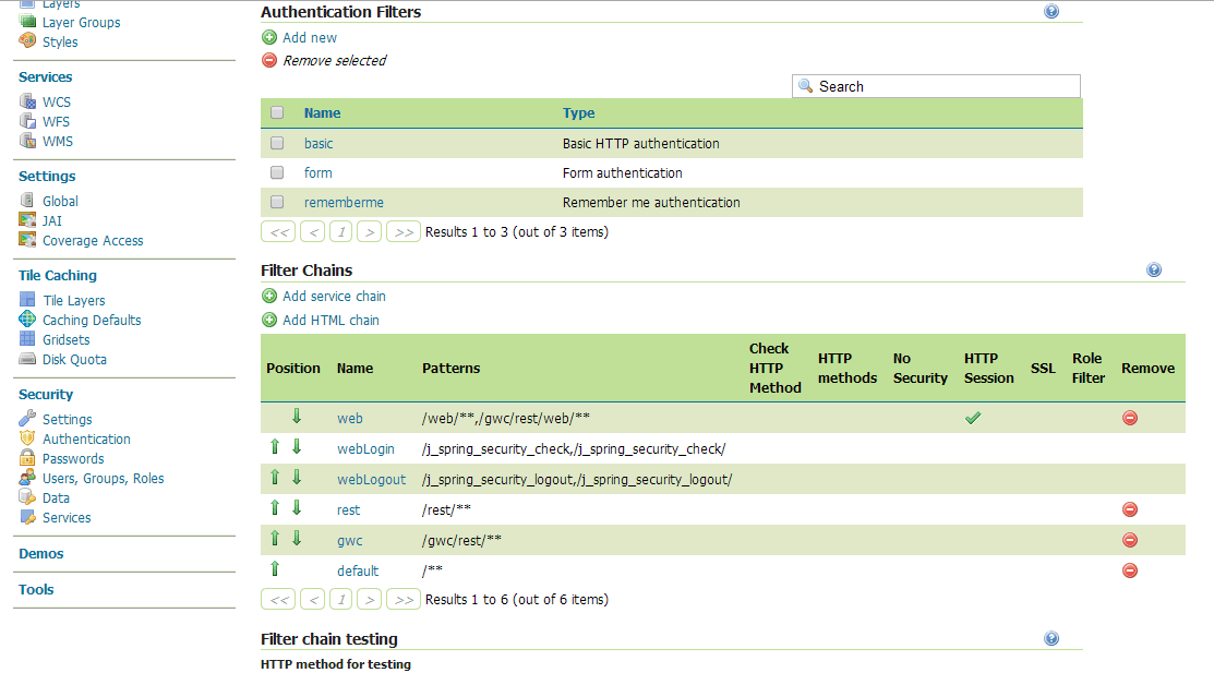

This is the configuration picture. I have removed the Anonymous on all
filter chains and authentication filters.
(Embedded image moved to file: pic30776.gif)

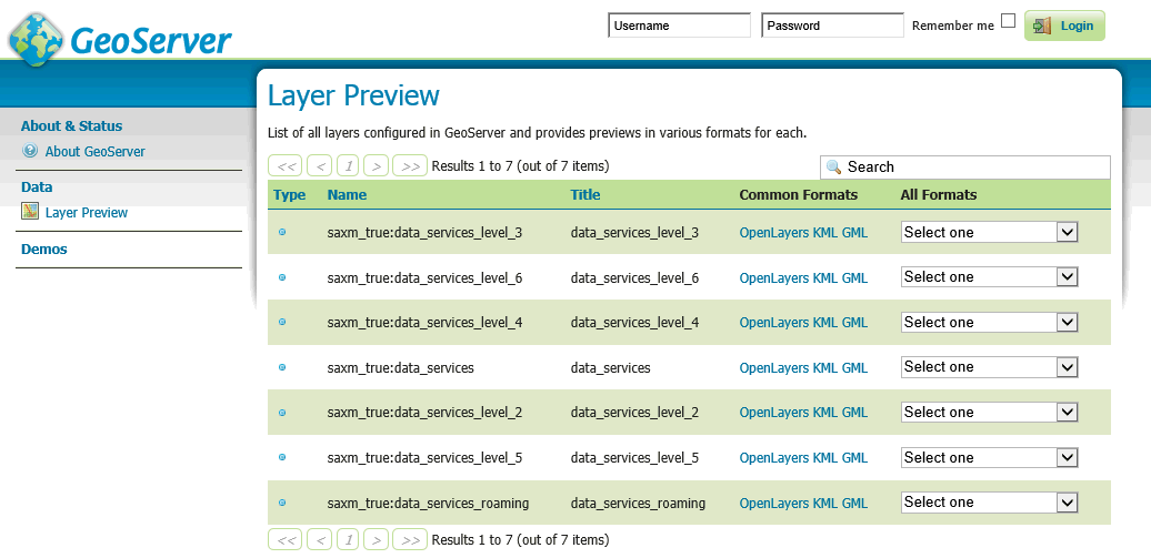

When I access the web tool with out authentication, I can still access web
tool.
(Embedded image moved to file: pic09377.gif)
Can you suggest how to disable anonymous?
  On your document,

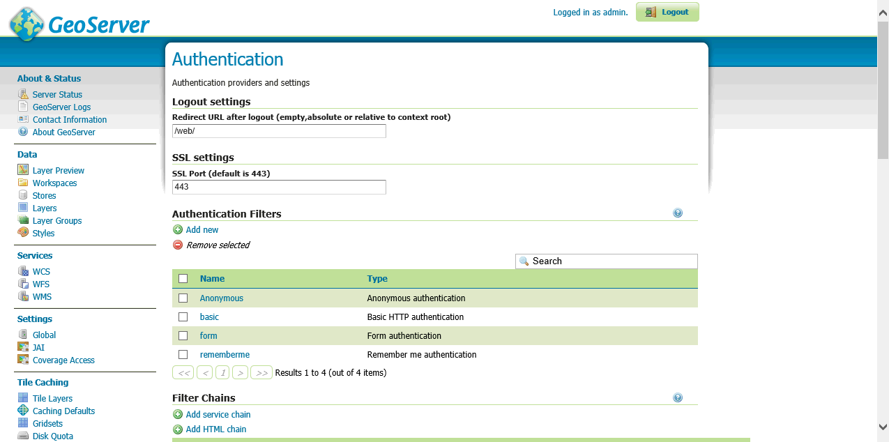

Thank you for your suggestion
Yes, I saved after change configuration and you are correct that I just
don't want anonymous user can access web.
I changed as your suggestion but the anonymous user can still access web as
picture below.
(Embedded image moved to file: pic10872.gif)

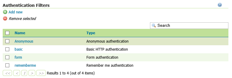

On setting, I have added anonymous in authentication filters
(Embedded image moved to file: pic06923.gif)

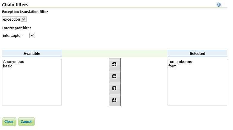

and do not select anonymous and web "filter chain"
(Embedded image moved to file: pic03738.gif)
Please help to solve this issue.

Hi,
did you clicked on "Save" button at the end of the page, and empty the
browser cache and retried?
Sorry but I tried and it worked for me.
I understood you don't want to disable the anonymous access at all, but
only for the web view.
In this case you should add the anonymous entry to the authentication
filters and remove "anonymous only from the "web" entry in the filter
chain.
That's what I see if I do it and try to access as anonymous user (I can not
access to the layer preview without authentication).
Immagine in linea 1
.Is it what you want?
To be sure, try to remove the remeberme filter
Cheers
Christian
picture below.
and do not select anonymous and web “filter chain”
