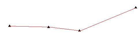

Hi,
I went through the tutorials but am still not sure how I can apply the
inline feature to my implementation.
To be more precise, the map I retrieved using the following request returns
me a layer with four features (as shown in the attachment, if it can be
received by the mailing list). How can I actually change the SLD below such
that I can draw lines that joins up the four features (again, shown as red
lines in the attachment if it's viewable)? How can I use the inline feature
to do that?

Hi,
You will first need to create the lines from the points you receive. The line just has to be made of two of the points: start point and end point. Then you need to format those lines into GML:
<gml:LineString>
  <gml:coordinates>x1,y1 x2,y2</gml:coordinates>
</gml:LineString>

Lee Wai See wrote:
Hi,
to do that?

Hi,
<gml:LineString>
</gml:LineString>
Then you will send a new SLD back to Geoserver, with a getmap request, that
has the inline features. (follow this tutorial but change the polygons to
linestrings: http://docs.codehaus.org/display/GEOSDOC/InlineFeature).
You will get back the correct map that has the lines drawn between the
points.
So to summarize how it will work:
1) client -> geoserver: normal get feature request
2) client <- geoserver: gml of the point fetures
3) client: build up lines from the returned points
4) client: create SLD with inline features containing the lines
5) client -> geoserver: getMap SLD post request with the new SLD file
6) client <- geoserver: map with the lines drawn in it
In the <UserSytle> section of the SLD you will have to point to the inline
feature names.
I haven't played around with inline features much, so you will have to
tinker and play with the tutorial to get it working.
Brent Owens
(The Open Planning Project)

The first request would be a WFS getFeature request. This will return you GML (step 2) that you can parse into points. Then from that you can generate lines. Then send back a WMS request with the inline features passed in the SLD post getMap request.
Here is some clarification on the types of requests:
WFS: returns GML features. These have attributes and geometries. It is all XML
WMS: returns raster images (jpeg, png...), a map
Take a look at the specs to learn a little more about them. It is good to get a broad sense at what the capabilities are of both types of requests: http://www.opengeospatial.org/specs/?page=specs
cheers
Brent Owens
all XML
cheers
Brent Owens
Lee Wai See wrote:
Hi Brent Owens,
Thanks for the reply.
Pardon my ignorance, but do I make WMS or WFS requests for steps 1 and 2?
Specifically, what are the requests I need to make? Thanks.
Regards,
Lee Wai See
ST Electronics (Info-Software Systems) Pte Ltd
-----Original Message-----
From: Brent Owens [mailto:brentowens@anonymised.com]
Sent: Thursday, March 02, 2006 3:25 PM
To: Lee Wai See
Cc: geoserver-users@lists.sourceforge.net
Subject: Re: [Geoserver-users] Drawing a line between two features &
Labelling a feature
Hi,
<gml:LineString>
</gml:LineString>
that
points.
feature names.
Brent Owens
returns
such
red
feature
to do that?
returns
such
feature
to do that?
