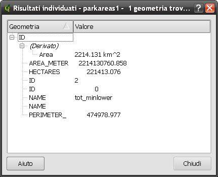

Hi,
I downloaded the file and tried it out, and I can confirm it's broken,
at least from the GeoServer/GeoTools point of view.
The DBF has duplicate attributes for good, it has two ID and two NAME
fields, and unfortunately our feature model is strict and does not
allow that.
See for yourself with this screenshot I took from QGIS, which has a less
strict operation mode and allows for duplicated attributes (attached).
Anyways, no all is lost. I opened the dbf with OpenOffice Calc, removed
the two extra columns, and saved it again (you can do the same with Excel). Then I could show the file contents just fine.
