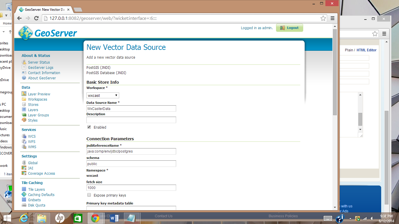

I'm starting to catch on with trying to configure PostGIS Database (JNDI) (from March, just getting back to it). I've installed Tomcat 8.0, deployed the GeoServer 2.5.1 War using the Apache Tomcat Manager web page.
I've added to context.xml in C:\Program Files\Apache Software Foundation\Tomcat 8.0\conf
   <Resource name="jdbc/postgres" auth="Container" type="javax.sql.DataSource"
             url="jdbc:postgresql://127.0.0.1:5432/WxCasterData"
             driverClassName="org.postgresql.driver"
             username="geoserver" password="geosever"
             maxActive="20" maxIdle="3" maxWait="10000"
             poolPreparedStatements="true"
             maxOpenPreparedStatements="100" />
in C:\Program Files\Apache Software Foundation\Tomcat 8.0\webapps\geoserver\WEB-INF I added to web.xml:
      <resource-ref>
      <description>Postgis Datasource</description>
      <res-ref-name>jdbc/postgres</res-ref-name>
      <res-type>javax.sql.DataSource</res-type>
      <res-auth>Container</res-auth>
   </resource-ref>
   Attached screen capture are the entries in the actual adding the Postgis JNDI store interface. I get
Caused by: java.sql.SQLException: Cannot load JDBC driver class 'org.postgresql.driver'
  at org.apache.tomcat.dbcp.dbcp2.BasicDataSource.createConnectionFactory(BasicDataSource.java:2000)
  at org.apache.tomcat.dbcp.dbcp2.BasicDataSource.createDataSource(BasicDataSource.java:1896)
  at org.apache.tomcat.dbcp.dbcp2.BasicDataSource.getConnection(BasicDataSource.java:1412)
  at org.geotools.jdbc.JDBCDataStore.createConnection(JDBCDataStore.java:1764)
  ... 116 more
Caused by: java.lang.ClassNotFoundException: org.postgresql.driver
  at org.apache.catalina.loader.WebappClassLoader.loadClass(WebappClassLoader.java:1333)
  at org.apache.catalina.loader.WebappClassLoader.loadClass(WebappClassLoader.java:1180)
  at org.apache.tomcat.dbcp.dbcp2.BasicDataSource.createConnectionFactory(BasicDataSource.java:1991)
  ... 119 more
  any ideas?

Did you add the postgres jdbc driver in the tomcat lib folder, and removed
it from GeoServer own WEB-INF/lib?
