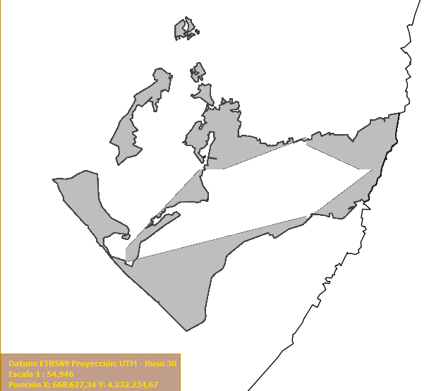

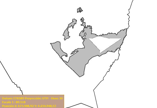

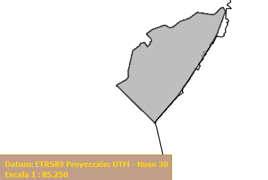

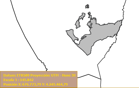

I recently updated to version 2.5.2 geoserver, since then I have display errors with multipolygons.
At a higher level, the geometry is represented well but if I get closer there are errors.
I’ve been looking at the logs and what I’ve found in some cases:
“13/10/2014 18: 07:. 10,347 DEBUG [org.geotools.util] - Converting Geometry POLYGON ((…)) to LineString This Could Be Unsafe”
The layer is from postgis 1.5.
With geoserver version 2.5.0 everything was ok.
I put some pictures to see the problem.
Cheers
Hi list,
I found the problem.
In my table geometry_columns from PostGIS there was a duplicate record for my table, one with the correct geometry (multipologon) and one with incorrect geometry (MultiLineString). Removing the wrong record solved the issue.
