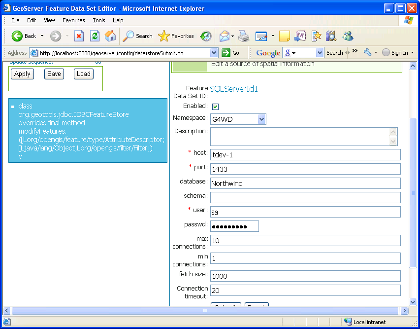

Hi Keith,
IN step 9, the blue box on the side denotes the error so the datastore is not being set up properly. To me that errors indicates that there could be a version mismatch with some of the geotools libraries. You are running geoserver 1.7.2, did you download the 1.7.2, or 1.7.3 version of the sql server extension?
-Justin

Hi Keith,
-Justin

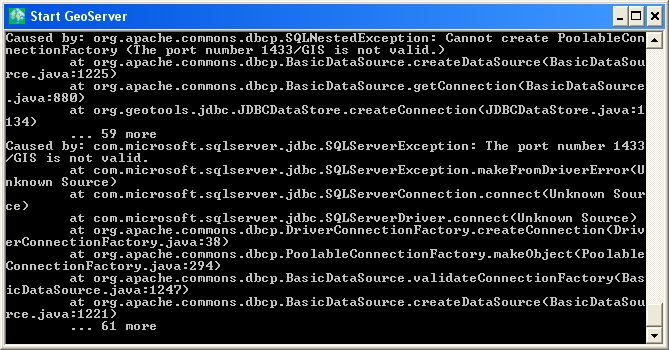

Hi Keith,
So this error seems different, and that the port number is not specified properly.
Check out this previous user list email:
http://www.nabble.com/SQL-Server-2008-datastore-connection-td22461607.html
Step one mentions making sure the ports are set up properly... and that static ports are used. Can you verify that list of stuff is set up?
-Justin

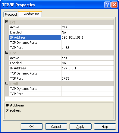

Hi Justin,
I started SQL Server Configuration Manager, At SQL Server Network Configuration, selected Protocols for SQLEXPRESS.
TCP/IP is Enabled and clicked TCP/IP, and I got the configuration for port
Thanks
Keitt
properly.
are

I’m able to create datastore for SQL Server. But I got “Unable to obtain connection” if entering database name in database field
When creating or editing a datastore.

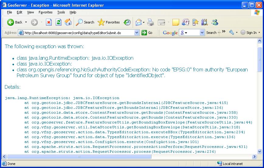

I created a FeatureTypes for the PostGreSQL datastore without any problem.
Then I did samething for the SQLServer datastore. When clicking the button Generate at Bound Box: it displayed error message
I copied Min Long, Min Lat, Max Long, Max Lat from the FeatureType created for PostGreSQL datastore and pasted to
the SQLServer FeatureType’s.

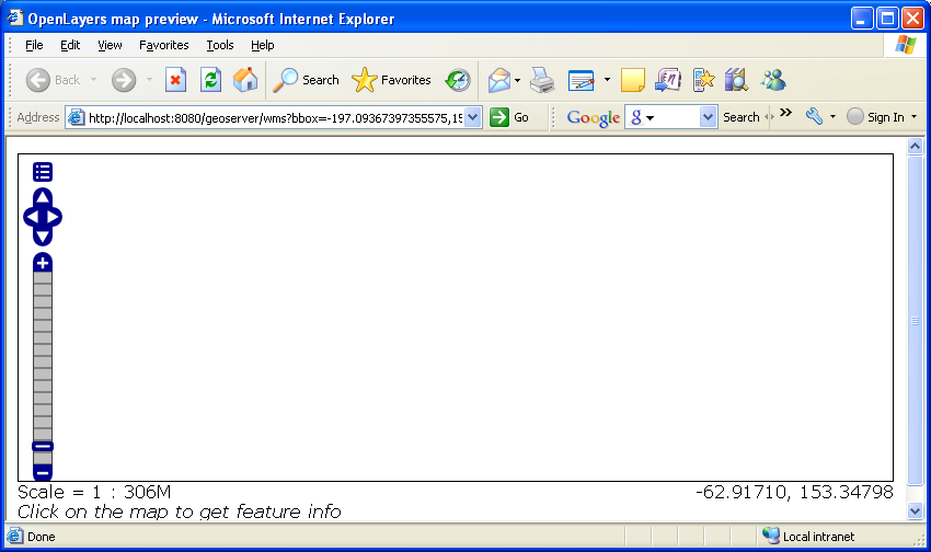

Then, I viewed the FeaterTypes by clicking OpenLayers in geoServer at welcome.do. I selected the FeatureType
Created for PostGreSQL datastore, it displayed map well (I got same result by the FeatureType created by shape file directly).

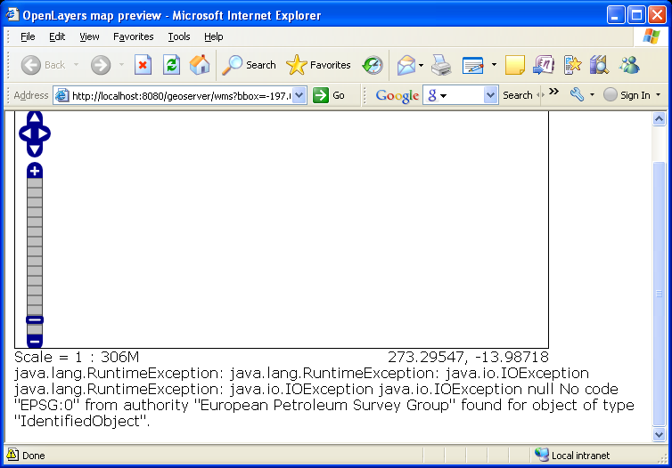

But when clicking the FeatureType created for SQLServer, it shown a screen without map inside
When playing around and tried to find map, I got error message
Can you help for it?
