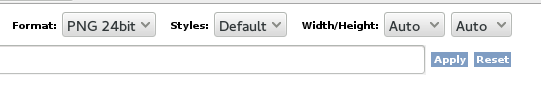

One small thing; If you open the options on the layer preview; the
buttons are a bit small (see attached screenshot) these can be
enhanced by setting the padding on the css style for
#updateFilterButton, #resetFilterButton
to 1em.
