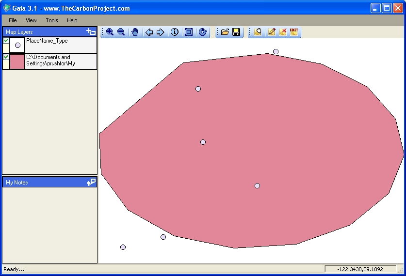

Hi Justin,
I can see how the parser might make a mistake on the query
Chris sent but it is still missing something even when the
gml:Polygon is correctly encoded, like this:

when you can see from the attach screen cap there are a few points in
the polygon anyway.

Rushforth, Peter wrote:
Hi Justin,
<?xml version="1.0" encoding="ISO-8859-1"?>
<wfs:GetFeature xmlns:wfs="http://www.opengis.net/wfs&quot;
xmlns:gml="http://www.opengis.net/gml&quot;
xmlns:ogc="http://www.opengis.net/ogc&quot;
xmlns:xlink="http://www.w3.org/1999/xlink&quot;
xmlns:xsi="http://www.w3.org/2001/XMLSchema-instance&quot;
xmlns:gb="http://www.geobase.ca/interop-pilot-2007&quot;&gt;
  <wfs:Query typeName="gb:PlaceName">
    <ogc:Filter>
      <ogc:Within>
        <ogc:PropertyName>gb:pointLocation</ogc:PropertyName>
        <gml:Polygon>
          <gml:outerBoundaryIs>
            <gml:LinearRing>
              <gml:coordinates>-122.52761667061144,59.192760330449438
-122.4575877169498,59.252028218626123
-122.38739127851342,59.259769033048563
-122.34165270787207,59.250858470514459
-122.30406217988482,59.231752461155438
-122.28036104576334,59.205389483385254
-122.27348450636205,59.175118353599771
-122.28625611979614,59.142982020266686
-122.31812701855206,59.116571374048711
-122.36341204823977,59.100535230548942
-122.4152093947729,59.097308848708643
-122.46474385594662,59.107565861858625
-122.50364892090293,59.129444947938218
-122.52595227387475,59.159618032484481
-122.52761667061144,59.192760330449438</gml:coordinates>
            </gml:LinearRing>
          </gml:outerBoundaryIs>
        </gml:Polygon>
    </ogc:Within>
    </ogc:Filter>
  </wfs:Query>
</wfs:GetFeature>
returns
<?xml version="1.0" encoding="UTF-8"?>
<wfs:FeatureCollection numberOfFeatures="0"
timeStamp="2007-11-02T02:44:52.141-07:00"
xsi:schemaLocation="http://www.geobase.ca/interop-pilot-2007
http://office.refractions.net:21880/geoserver/wfs?service=WFS&amp;versio
n=1.1.0&amp;request=DescribeFeatureType&amp;typeName=gb:PlaceName
http://office.refractions.net:21880/geoserver/schemas/wfs/1.1.0/wfs.xsd&quot;
xmlns:ows="http://www.opengis.net/ows&quot;
xmlns:wfs="http://www.opengis.net/wfs&quot;&gt;&lt;gml:featureMembers/&gt;&lt;/wfs:Featur
eCollection>
the polygon anyway.
Cheers,
Peter
