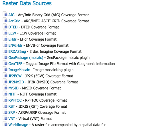

Also, here is the screen shot of the data sources - so yes, i believe I see the jp2000 store:
Really at a loss for what is going on here. It all seems correct.
