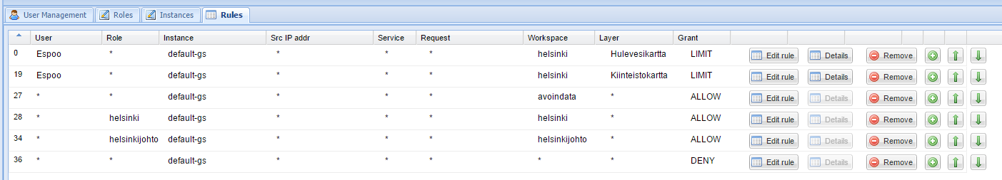

How does LIMIT parameter works for raster layers? Or for vector layers as well. I tried to define an area to be published from one certain raster layer. I used this Allowed Area parameter at Layer Limits
SRID=4326;MULTIPOLYGON (((24.94601815481079 60.133969115637946, 24.945974007763702 60.160895510936726, 25 60.160906522783534, 25 60.13398011556427, 24.94601815481079 60.133969115637946)))
Rule is successfully saved but without map output.

I tested again the LIMIT rule. Now I was able to get only limited area for layer using postgis as a data store. Found this info https://github.com/geoserver/geofence/wiki/Main-concepts how this LIMITing works.
Action
The Action specifies the outcome of the rule, if matched (by the filter) and selected (according to priority).
The two main actions are ALLOW and DENY. If one of these actions is encountered, the outcome is straightforward.
There’s also the LIMIT action. Limit ing rules add constraints to the final outcome, if it’s an ALLOWaction. Constraints can be area constraints or access mode constraints.
In order to make it clearer, here is a skeleton of the rule selection mechanism:
  1. Given a filter, read all matching rules;
  2. Reading the rules in the proper priority order, check:
    1. if the action is limit, collect the constraints in this rule and go on examining the next rules
    2. if the action is deny, the request is not authorized.
    3. if the action is allow, the request is authorized; the collected constraints, if any, shall be merged and applied.
But with these helps I was not able to publish any raster image, I only get blank image.

Thanks again your answer. I understood the LIMIT rules behavior as you commented and I have only standalone plugin installed. But still unfortunately I’m not able to see raster map which data store is WorldImage. Unfortunately in your GIF there wasn’t any rules – only picture of Geofence admin GUI, Rules sheet open and “No data to display” text.
I hope you can see the attached pictures. I have these six rules. Bottommost denies access to whole service. Fifth, fourth and third rule gives access to different workspaces according to the roles. With first and second rule – the user is member of the role “helsinki” – I want to limit the layers “Hulevesikartta” and “Kiinteistokartta” to be seen only in the area
SRID=0;MULTIPOLYGON (((24.94601815481079 60.133969115637946, 24.945974007763702 60.160895510936726, 25 60.160906522783534, 25 60.13398011556427, 24.94601815481079 60.133969115637946)))
Hulevesikartta is PostGIS based layer and Kiinteistokartta uses WorldImage datastorage. First layer is published with limitation without any problem. For second layer I only get blank image. Layers outside these two rules for that user are published normally.
Best regards

LIMIT rules only provide “limitations”, others rules will be responsible to ALLOW or DENY the access to a specific resource.
Let’s say that we have a LIMIT rule that only allow the current user to see a part of the map, if there is no other rule that
allows the user to access the map the user will get an empty map (since he is not allowed to access the resource).
On the other hand, if there is a rule that allows the current user to access the map the user will able to request the map but
will only be able to see the map content allowed by the LIMIT rule.
I made a few tests using GeoServer Master and GeoFence Master (using GeoFence stand alone) and I was able to define with
success limit rules for vectors and rasters. Note that when using GeoFence stand alone only the plugin “geofence” should be
installed (i.e. the plugin “geofence-server” should not be present).
In the GIF I send with this mail I define a rule allowing every user to do everything and a limit rule that will limit the map
content with a geometry. Note that security rules apply to all users except the admin user (he will always able to see everything).
The rules order is important, if GeoFence match against a LIMIT rules we will keep on until a rule that allow or disallow the current user
is found, if no rules allowing or disallowing a user is found by default the user will not be able to access the resource. So limit rules
should appear before the rule allowing or disallowing the user.
I perform some tests using GeoServer packed data (for vector data the layer “topp:states” and for raster
data the layer “nurc:Img_Sample”) and everything went fine.

Hi,
Here is the image for rules.
BR
Ville Jussila
Lähettäjä: Jussila Ville [mailto:ville.jussila@…7074…]
Lähetetty: 17. elokuuta 2016 11:07
Vastaanottaja: ‘nuno.oliveira@…1107…’ <nuno.oliveira@…1107…>; ‘geoserver-users@lists.sourceforge.net’ geoserver-users@lists.sourceforge.net
Aihe: Re: [Geoserver-users] Geofence - LayerGroups
Hi Nuno,
Best regards
Ville Jussila

Hi,
I hope this helps.
