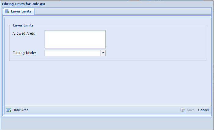

Actually I spoke too soon. In my use of geofence I don’t see how a LIMIT rule can limit feature attributes returned by WFS. The Editing Limits dialog gives me a way to define an Allowed Area. But it does not let me specify feature attributes to limit.
